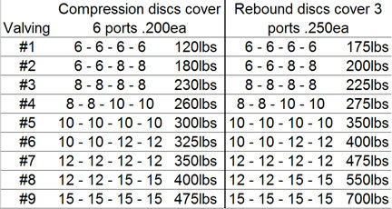

One of the articles I found earlier provided valving information which I suspect would be sufficient to permit making adjustments yourself:
"2.0 monotube valving stacks are made up of 4 discs that control the compression and rebound based on the thickness of each disc stacked on top of each other. These discs flex upon the entry of oil through the piston port. The ports in the pistons have 3 rebound ports and 6 compression ports.
Below you will find the basic valve stacks and the dampening forces produced using the stacks listed for both compression and rebound. The valving that is installed in your new shock is the base line or "medium" valving for that type of vehicle. Valving or dampening forces are determined by personal preferences, i.e. soft, medium, firm
Doetsch Tech Shock Valving
Other than oval track applications, valving's are very rarely #1 over #1 "50/50 style", typically the rebound side is always greater (thicker discs) than the compression side. Here is an example of a very common medium valving and how it is described.
Medium valving: #2/#5, or 2 over 5, or 2/5 This means you use discs from row #2 for compression and discs from row #5 rebound. Using these you would have a valving of 180 lbs. of compression and 350 lbs. of rebound."
