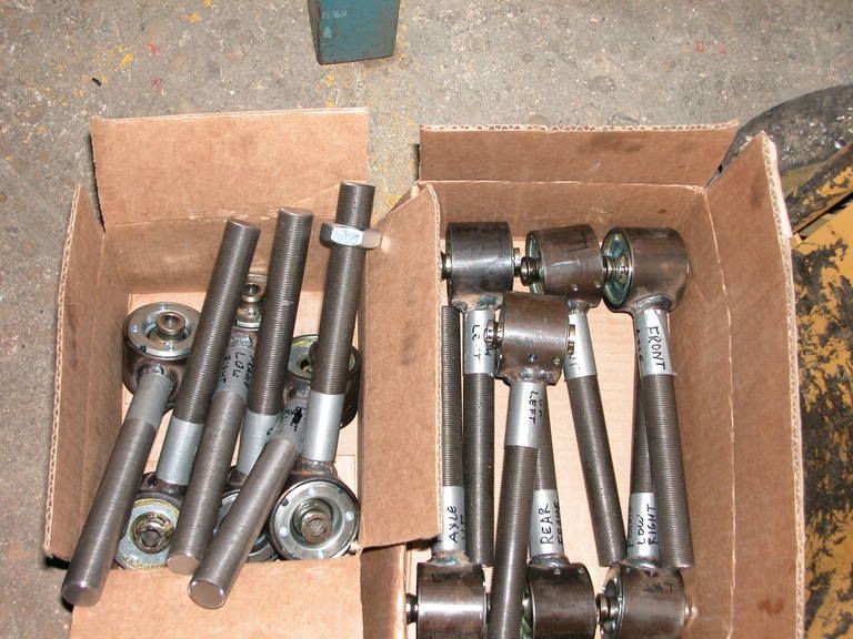

kid4lyf said:
Wow, a common ground. :kissyou:
REs can't be beat. Kinda pricy, though.
http://i27.photobucket.com/albums/c192/kid4lyf/DSCN0016.jpg
13 SF joints @$40
Agree with vetteboy, all mine are rt/lft threaded w/ jam nuts.
Tighten the jam nuts and they won't come loose.
Being able to adjust without removing is too important to even consider not doing that.
I even built the mounting brackets to allow for tightening the RE joint itself without unbolting.
http://i27.photobucket.com/albums/c192/kid4lyf/REmount.jpg
Is it difficult to get a good enough grip to turn the links? Do you have flat spots machined into them? Do you just grab them with vice grips?

Flats
