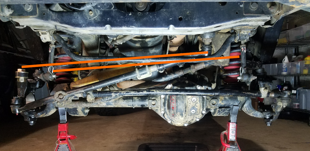

I'm looking for a sanity check on a plan here. The TREs on the Currectlync setup that I've had on my woods beater for the past few years have gotten worked out and there's a ton of slop in my steering anymore. I'm planning to rebuild the front-end to get some additional down-travel and beef things up. I bought a Teraflex high-steer knuckle a while back as a starting point, and this is what I'm looking at:
The governing angle is the drag-link to the knuckle. In order to get the trackbar parallel and the same length, I am looking at Stinky Fab adjustable axle-side bracket [1] near the inner C, and an out-boarded body-side bracket such as the Ruff-Stuff outside panhard bracket [2] (or maybe the Alpine Peak bracket [2b]). I may not have enough room to make the links exactly equal. Tie rod will go OTK on both knuckles (assuming the end link will fit below the drag link end, which it should).
Other items on the work list are JCR front stiffeners [3] to beef up the trackbar and steering (using their mids and want to match for fitment), TMR truss that works with this TJ Rubi D44 [4], Undercover Fab UCA passenger weld bracket [5] (had it before), and Artec inner-C gussets.
I have not decided on the links or ends yet. I'm favoring Summit Machine ends at the moment. I would probably buy their links too but their order page has gone missing so not sure they are selling those direct anymore. TMR sells some aluminum made-to-order for not too much so might do that. Suggestions appreciated.
Overalll I'm looking for a sanity check, if there will be problems that I'm not seeing.

Any reason you couldn't go OTK with the drag link end on the Teraflex knuckle? I'm assuming the knuckle is probably tapered bottom-up. Could you drill it and use an insert to flip to a top-down taper and run the TRE up top for super flat steering? Not that its necessary, but if you're going this far...

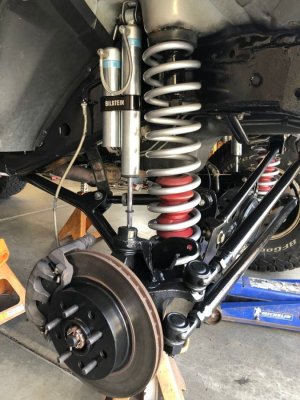

How are you planning on mounting the axle-side trackbar bracket out near the C? Are you coil mounts centered over the axle tube, or are they in front of the axle tube like the factory setup? If they're in front, there's no way you're getting the TB to the outboard side of the coil. If they're centered, it should work, but you'll likely need to put a bend in your drag link to clear the TB bracket. I just recently got my axle-side TB bracket placed on my JK 44 front. I put it outboard of the coil. There is just enough room for the drag link TRE at full steering cut, and I will need a bent drag link. I used an Artec JK Rear Trackbar Bracket JK4426 which is designed for a 3.15" diameter tube, but I modified it to fit.
I haven't placed my frame-side mount yet, but I also have a RuffStuff outside panhard bracket that I'm going to try to make work. I've had it in a box for years. I don't like that Alpine Peak Precision bracket because there is no adjustability at the frame side. I think that is important. Also, it says the bracket is 3/16" which feels a bit light. I think 1/4" is more appropriate for that mount.
I'm using GM 1-ton TRE's and 1.5" OD .250" wall DOM for my links. Tie rod uses the RuffStuff offset TRE's. I'm not sold on this approach and have been considering ordering a kit, but they're expensive. We'll see how this works out for me.
It would make the trackbar at the axle really high. It's a possibility but just eye-balling seems unlikely:
ps--the knuckle holes are not tapered, they are 7/8 straight.
Eye-ball looks like I can fit it in where the sway-bar link is installed, but I may not be able.

That does look awfully high when you draw it in. Nice and flat though.

Id definitely run draglink over the knuckle if youve got enough oil pan clearance.
Track bar can be lower at frame side to clear oil pan.
Most likly a custom axle side and frame side to end matching drag link and clear oil pan.
I do have custom frame axle side track bar and still dented my oil pan. But alittle witness mark never hurt anything.
