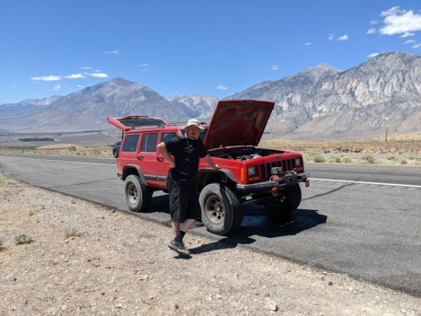

womp womp
The $40 wonder from amazon (Spectra) failed to contend against 6 degree climbs in 105 degree heat. Time for something better..
Gonna try out the Cold Case 2 row aluminum XJ radiator, and a stand alone derale trans cooler with 2 5" electric fans not in front of the radiator.
Updates later when parts arrive.

What water pump are you using?

In 100+ weather it started to run warm with AC on. Warm as in 237 via OBDII and validated with temp gun. Warm on any hill or in traffic.
Start thinking, is it running lean, fan issue, head problem...??? you know when you start reading threads to find that one nugget that could solve your issue.
So I said, I'll just flush it thinking it would not help as the coolant looks brand new. I pulled hoses, flushed radiator, back though heater core and then ran 2 gals of distilled water and drained again. I saw no sediment or garbage come out. Was very clean.
Filled with ~60/40 mix of distilled to coolant. I then ran it with the cap off with front uphill for at least 30 minutes till no air bubbles (heater running).
It runs like it should now. Max temp is 213 and quickly cools down. Most often runs at 206-210. Can idle in traffic at 95+ deg with no issues. Doesn't make sense that the flush did anything or letting it idle for so long to get all bubbles out helps as it is open system. I am glad I tried that first before throwing money at parts. Figured I would share for others out there.

GMB high performance. Pumps water just fine, simply didn't have enough radiator to handle the grade + heat + no humidity + 33's on 4.10's.
Thanks. I didn't mean to suggest it was a water pump issue. Was just curious what you are running. Are you running this pump on your other XJ(s)?
