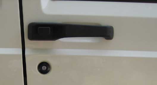

1. The easiest quiet way to break into a cherokee without special tools is to pop off the passenger side door lock. They can be removed in seconds with a flat-blad screwdriver, and theives can access the unlock linkage with their finger.

I installed a kill switch and replaced my vunerable locks with carriage bolts. I now rely on my power locks to get the doors open, or the rear hatch which has the keyed entry. I keep a spare remote in the rear cargo area in case mine dies.

The first time was in hollywood, i parked on a side street to avoid the 12$ parking lot fee, and came back to seeing my passenger side lock cylinder hanging off the outside of the door. no special tools, no slim jim or wedge block and extended reach pull handle - they used a flathead screwdriver. just below the lock cylinder there is a 1/4 wide hole, which they punched with a screwdriver that I later found laying on the floor in the back. I dont know if they used a hammer or what, but I was only away from the truck for 15 minutes, so it happened fast. they punched this hole and pried out the entire lock cylinder, pulling the lock rod with it and unlocking the door.
