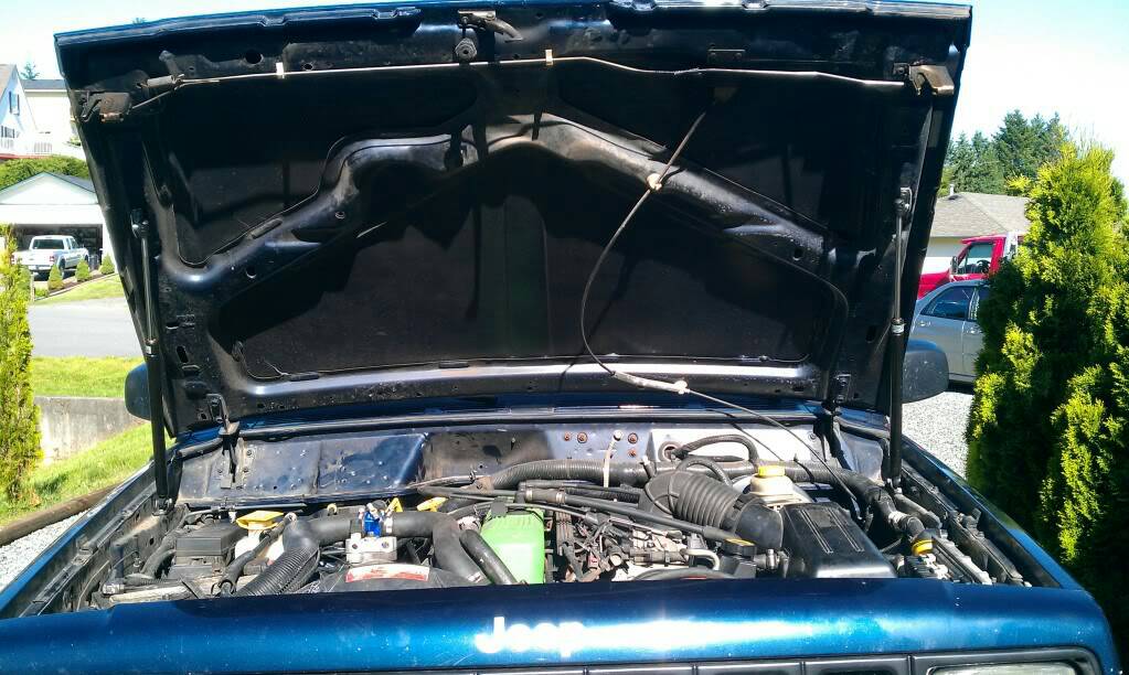

When I did mine I used my old worn out hatch struts, bought a pair of 10mm ball mounts and away I went. Cost me all of $20 CDN after screws and such. If you factor in the new hatch struts I bought for the rear, they were $28 each.
Hood's been raising itself beautifully for the last 5 or so years now. Makes life way simpler at given the lifted height of the engine bay. May add a pull strap so the wife can close the hood ... But I could forsee that getting caught in the fan accidently one day.

One old JY hatch strut, one old ball, 2 self tapping screws, and one nut. Didn't bother doing the driver's side.
$5.00. All done.
Even old worn out hatch struts have plenty of lift for the hood. Two birds, one stone. Old hatch struts to the hood and replaced the hatch struts with new. Win, Win.

How did you determine where to mount the struts?
I part out XJs and I've got lots of old struts and the pivot balls.
Zoom in on that last pic, then zoom in on the one I posted. No one right or wrong way. He mounted his pivot ball way up on the hood; I mounted mine on the inside of the fender. I mounted close to the hood hinge; he mounted close to the firewall.
I just held the hood with the factory arm and then decided from there where to mount knowing that at that height the strut would be at full extention.
You just have to worry about collapsed lengths with these. Really the easy way is to measure the distance between the mounts on the hatch and work off that.
