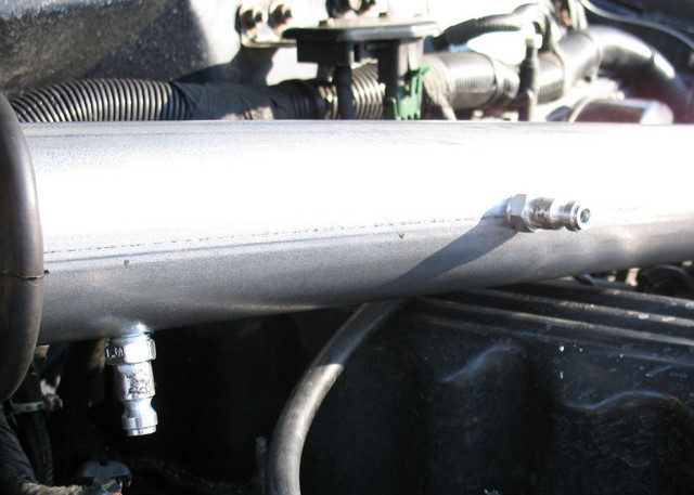

when you guys did the cowl intake and got rid of the stock airbox what did you do with all the vacume lines?
Those two vacuum line connectors at the top of the airbox are actually removable just drill two holes in the pipe section of the intake and glue the vacuum connector in
