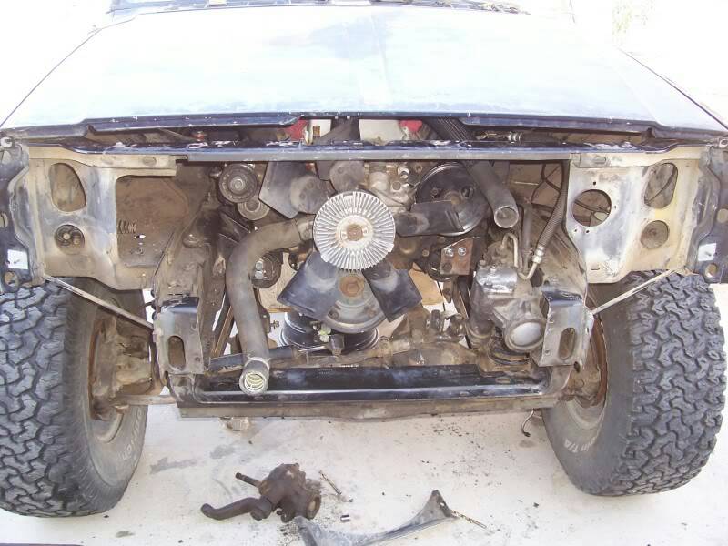

I have heard that about ZJ mounts, was worried about exhaust, but I think they would have worked. Biggest problem mounting the engine using the "ear" mounts up front is the steering box and shaft are in the way of the frame on the drivers side. Ended up fitting nicely. Even the Ram manifolds cleared the firewall. I did clearance a little with a big hammer.
ZJ mounts, ZJ manifolds, ZJ steering gear, ZJ y pipe.
I think using a ZJ donor simplified my swap. I had a line on a 5.9 but the 93 fell in my lap for $400 running. The 46RH trans was the deal closer for me.
