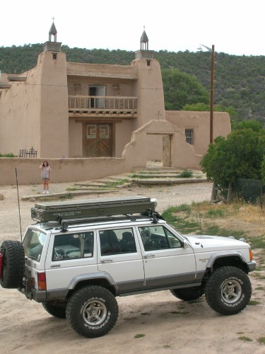

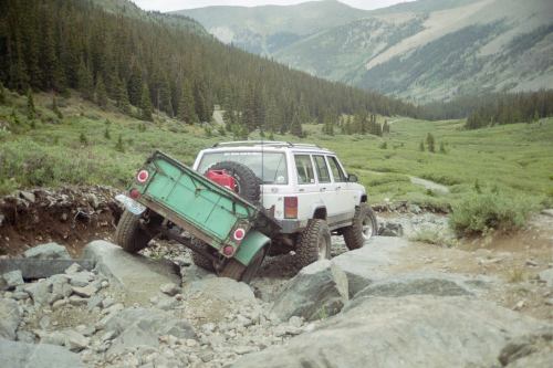

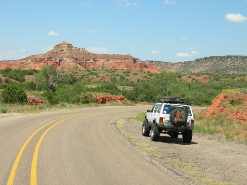

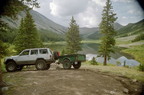

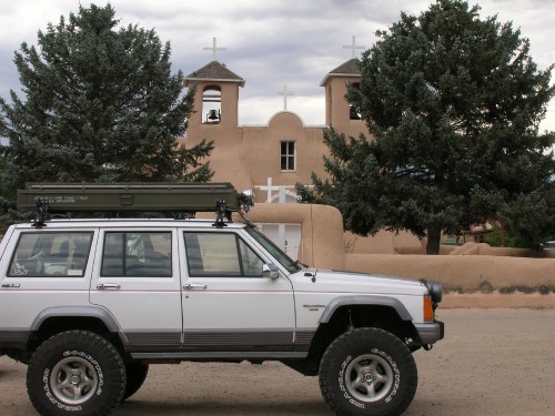

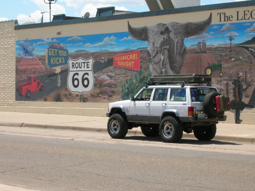

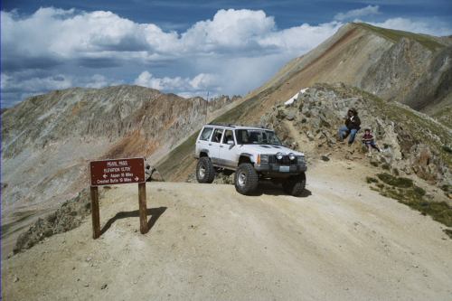

'91 XJ: AW4, 4.6L stroker, >250K miles on body and tranny, nothing else stock. It's been a daily driver for me since I bought it at ~80K miles and has been going off road in some form of lift for 150K. It was our primary vehicle until last March when we bought a newer car.
Presently 6.5-7" of lift (RE drop brackets and U/L adj control arms and National springs F&R), 35x12.5's GY MTR's (second set), a set of MTR 33's before them and two sets of 30's before that. Alloy axles and 4.56 gears in a D30 front, D44 rear. Terra disks and a '99 XJ/ZJ MC/booster/prop valve set up, custom over/under steering with high misalignment heims. 13.6 mpg around town, 10-16 mpg highway depending on load, wind and speed, and an occasional 19-20mpg in the mountains. Good power with the stroker around home, did better on 33's in the mountains but can still stay out of the slow lane most of the time as altitude. I Wish I had 4.88's with the 35's.
Big lift and 33's went on in 2000. I'm on my second set of front gears otherwise every driveline (excluding engine) issue has been driver induced. Drives as good as any lifted vehicle I've driven.
Pictures:
Colorado (Loaded for 2 week trip)
New Mexico, Arizona trip (loaded for another two week trip):
Bones :skull1:
