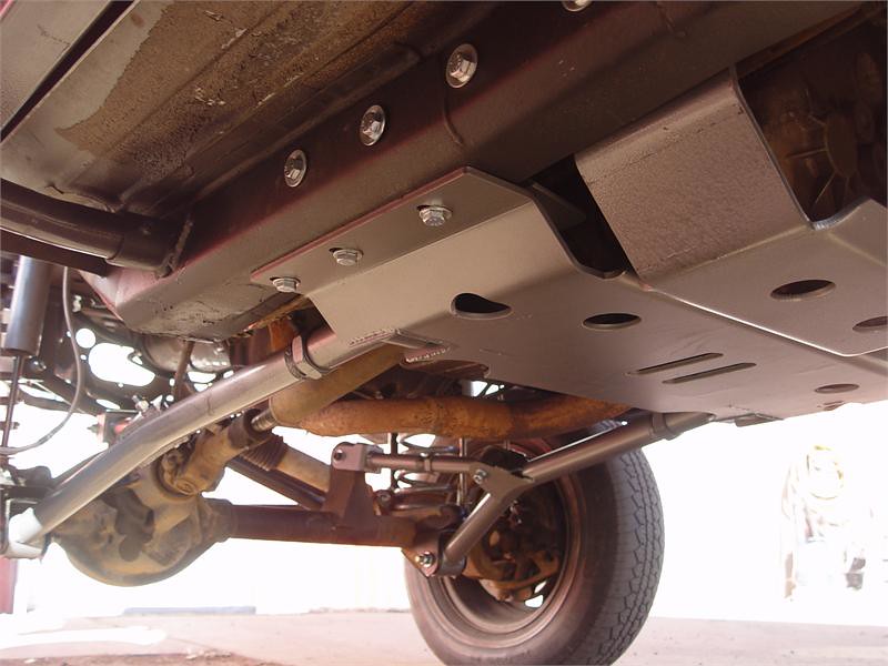

Here is a picture of the T&T kit for everyone to compare to the picture Muddeprived posted of his RC kit.

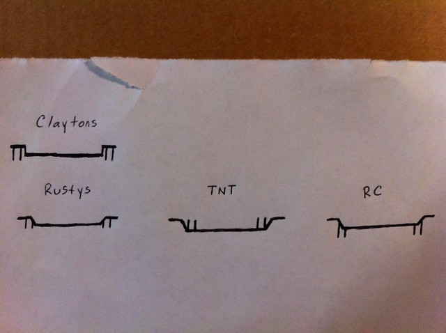

Here's a basic sketch I made of the different cross-member designs based on research & install photos Ive seen.
I couldn't find any good pictures of the RE crossmember but it might actually be similar to the T&T version.

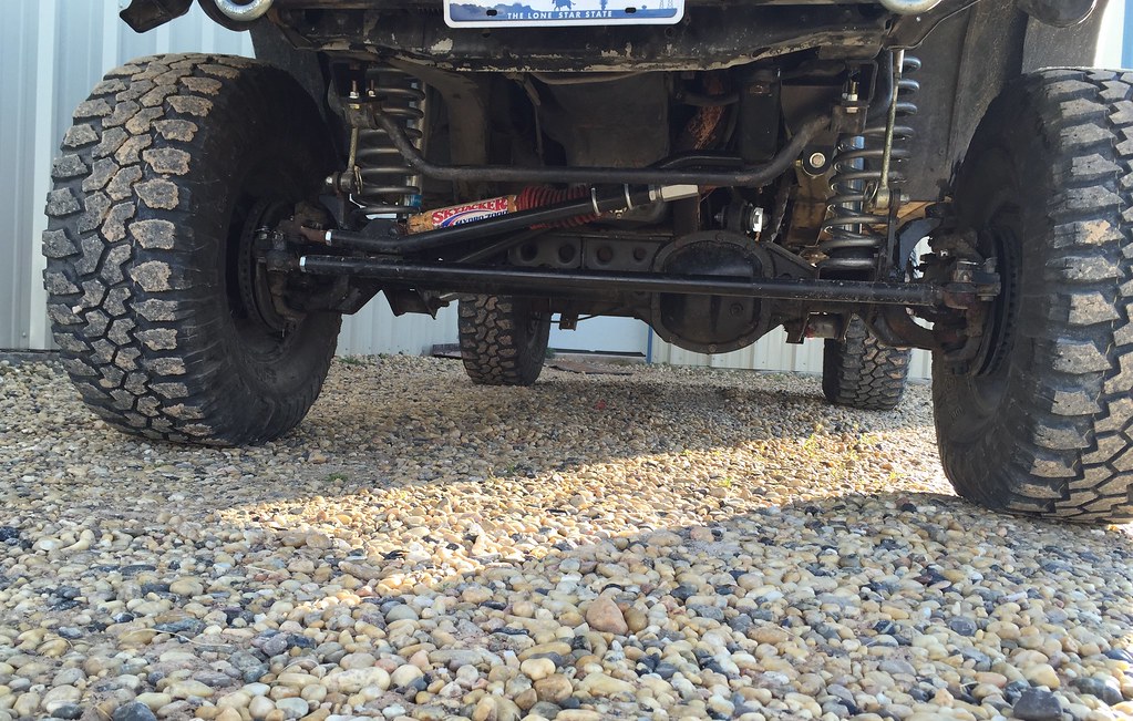

Just in case anyone is wondering what ever happened with this old Jeep, here's and update....
We decided to do the lift right & bought Rubicon Express 5.5" coils for the front and matching leafs for the rear, Bilstein 5100s all around, and a BDS 4-Link long arm upgrade.
After getting the process started & then letting it sit for a few years, I finally came to the conclusion that I was never going to get the project finished on my own... So I drug it up to San Angelo TX to see Matt & Mark at West Texas 4-Wheel & Offroad and turned the project over to them.
Since it was going to the shop anyway we decided to have a few other upgrades done... Artec Truss & C-Gussets for the D30, Spartan lockers front & rear, & Chromoly shafts for the Chrysler 8.25 out back.
On the steering side we brought them an ORO U-Turn kit and a IRO adjustable Track Bar.
The guys turning the wrenches over there did a great job as you might expect, even did some not-so-fun things for me like fixing the AC and replacing the dead fuel pump.
The Jeep rides like a dream off road now, night and day difference!
The on-road characteristics on the other hand still leave a bit to be desired... The vehicle wants to wander left or right on the highway and the tires tend to follow cracks in the road, there is no wobble at all but the bump steer is still present... The wandering from left to right & back again is most noticeable when driving in a straight line so taking a road trip in this thing would be exhausting.

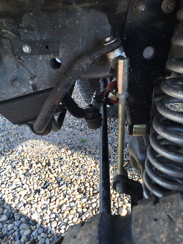

FWIW, your SB drop brackets are installed backwards.
The links are definitely to long like you had mentioned already.
I would like to ditch the drop brackets all together, but Idk if the sway bar would clear the drop pitman arm without them... Some shorter links are definitely in order, I'll play with the drop brackets when I replace the links.
