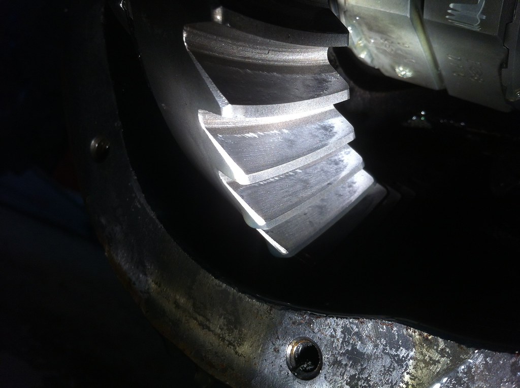

Popped off you diff. cover and stick a flat head under the carrier and see if there is any play in it,, either up and down or side to side. If so your carrier bearings are gone.

Since the noise is more noticeable under acceleration sounds like it may be pinion bearings. It's may be the shaft but sounds more like pinion bearings from the way you described it.

Took the driveshaft in to Inland truck today. The tech called me after 30 minutes and said the slip yoke on the shaft was toast. The holes in the yoke no longer hold the unjoint caps tight. And they spin also while in the yoke.
I feel stupid. I didn't notice slop in the u joint when installing. But thought "these sure are easier than my trucks u-joints to install, I don't even need my press"
The tech was convinced that's where my vibration was coming from.
We'll see
I get it back tomorrow afternoon.
Next ill try pulling the diff cover and seeing about those pinion bearings.
