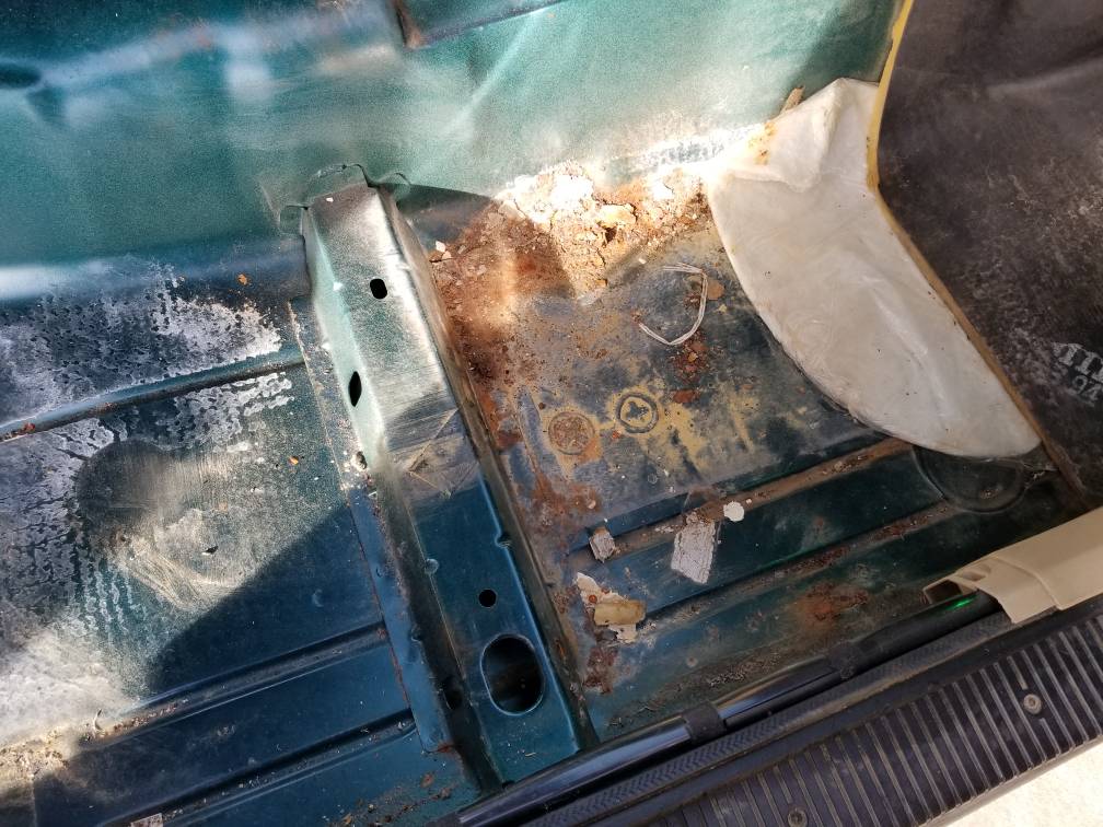

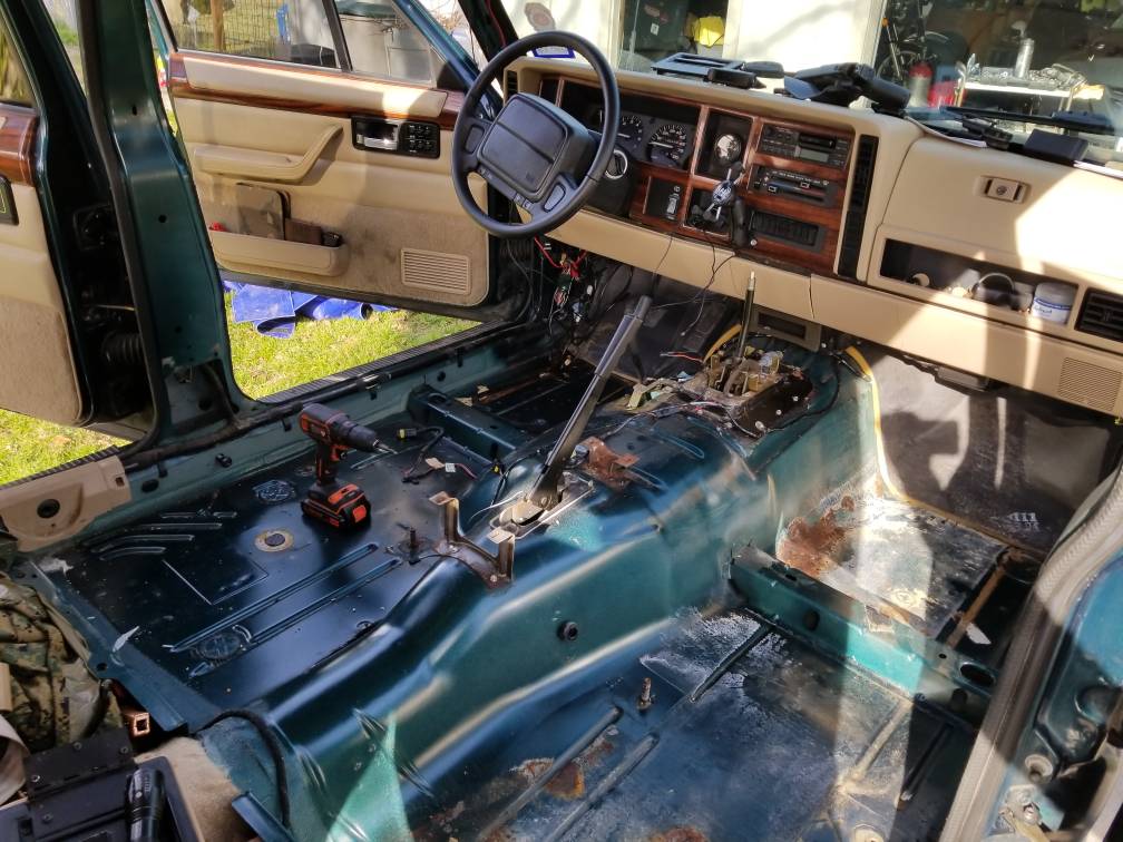

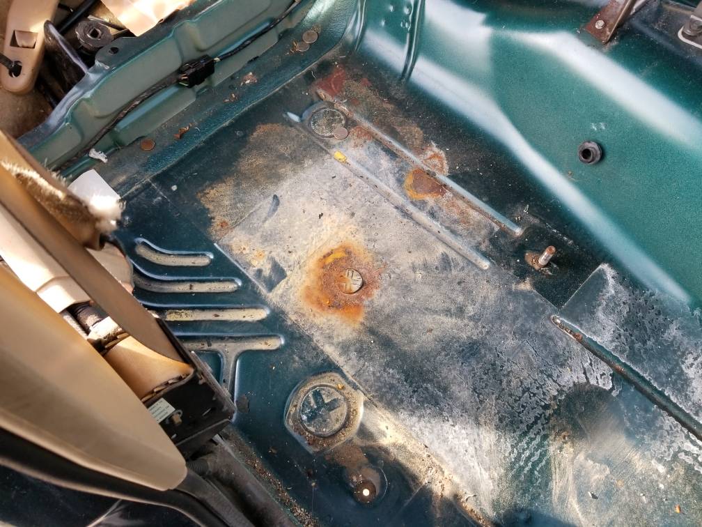

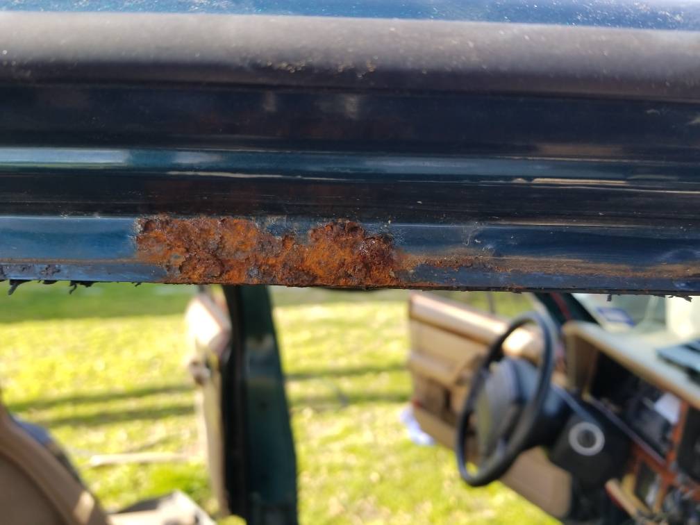

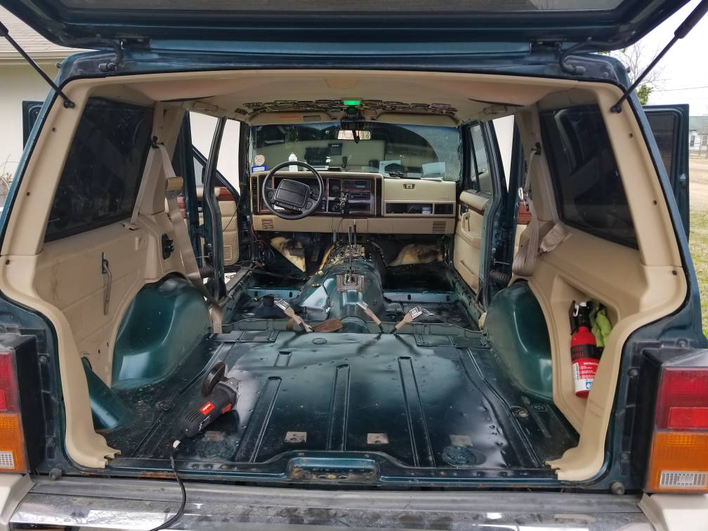

Pulled the interior hunting for rust, I also power washed the carpet while I had it out and replaced the weather strip on both front doors and the lift gate.

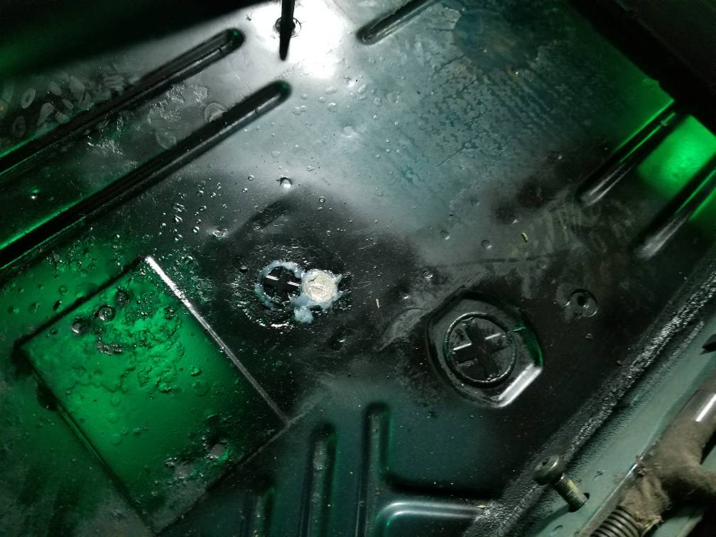

Found a few spots and a few small holes. Busted the rust out with a wire wheel and a flapper wheel. I tried to spot weld the holes but even on the lowest amperage i could run i kept blowing the holes out bigger 😑
So i hosed everything down with rustoleum top and bottom and used a tube of silicone and the change i found under the carpets to make my 1 dollar and 1 cent patch.
Certainly not professional haha.
So ill reassemble tomorrow after the carpets dry out and i give the sealant and paint time to cure.
