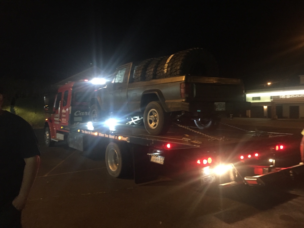

The last time these tires will ever see the road.
Yea..
Should of made it $114.99. And bought a radiator hose LOL
Quote of the night from nick "Weird.. Why is it only raining on one side of the windshield"
