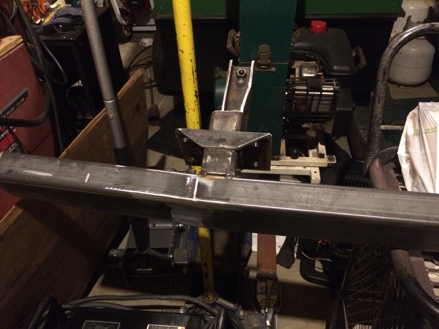

Wanted to post my DIY JCR bumper with mods
Basic JCR DIY Bumper:
Used 2x4, 3/16" thick, steel as a sleeve
Rivited the factory nut strips to the inside of the sleeve
Cut the factory hitch and welded it between the sleeves
Purchased spindle/tire ring from atoz fab
