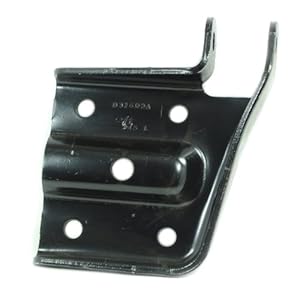

The plates I'm looking for look like this:
