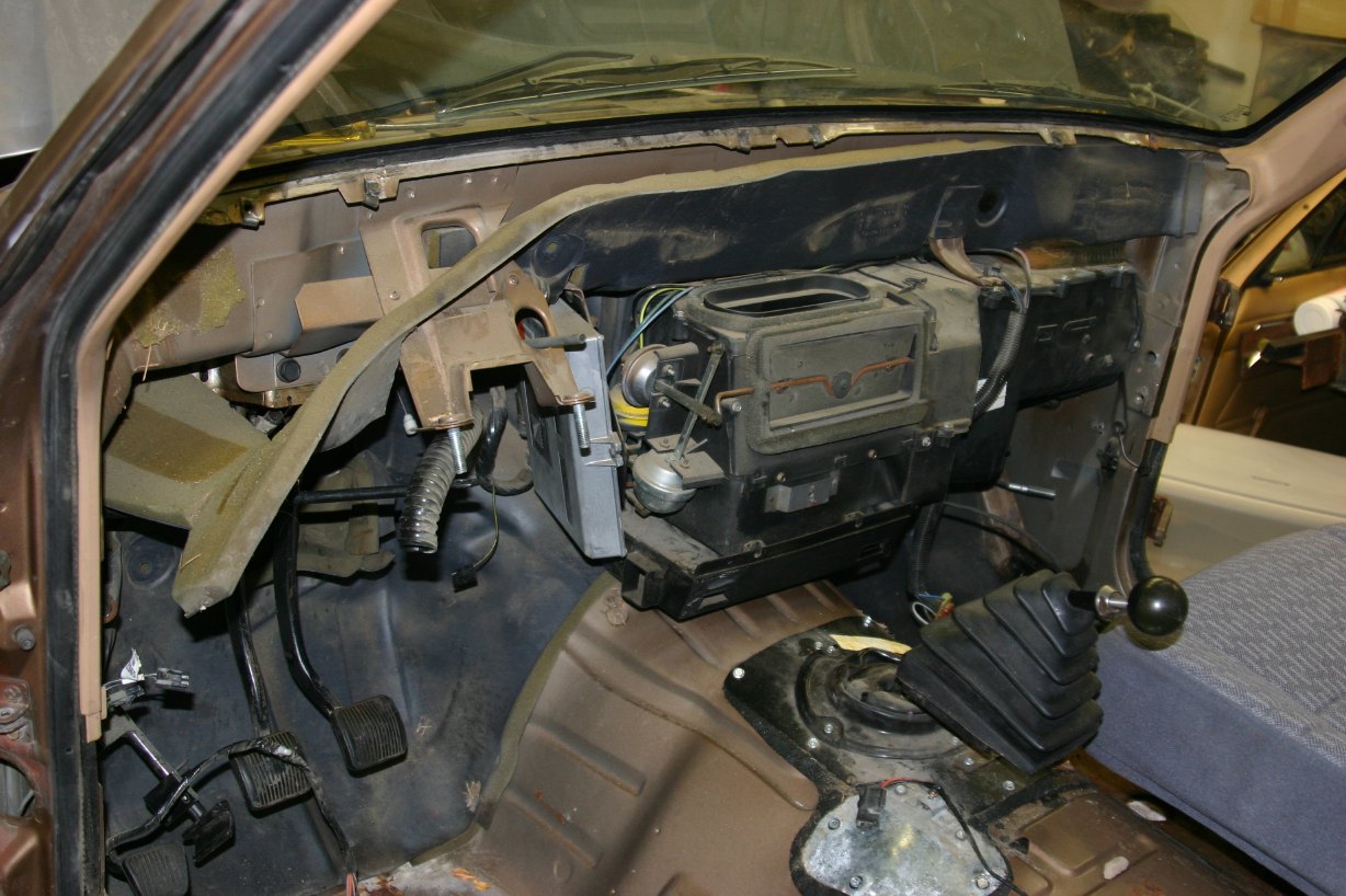

Ok did some more work, got the steering column, dash, and a few other things out of the way.

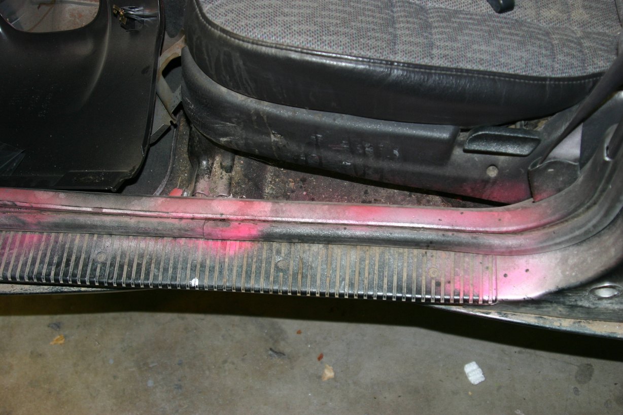

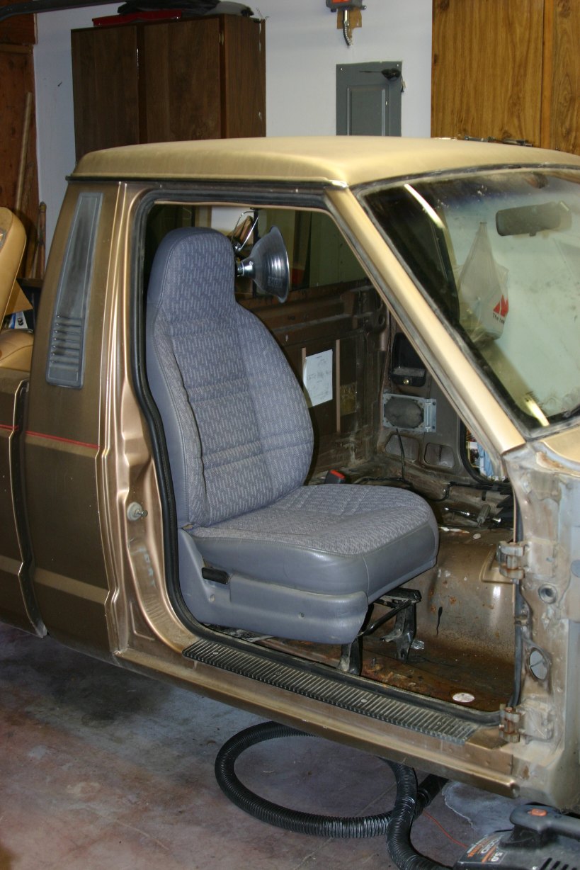

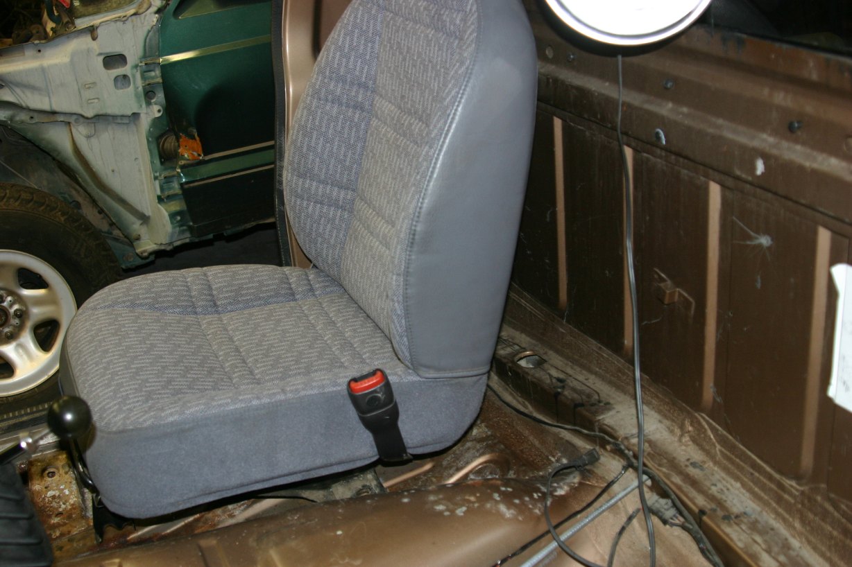

You can see where the front of the newer seat sits here:

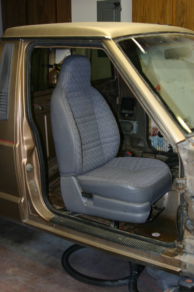

And so this is about where the front of the new seat will sit in the commanche, that little bit of bracket will be cutoff and the Xj seat bracket welded a little further back than that existing one. Basically the new XJ seat will sit exactly where the XJ seat would sit in a 97+ XJ.
Dash pulled, engine next so I can get the heater box out easier:

Seat forward:
Seat back:
Still some space to store stuff when the seat is back:

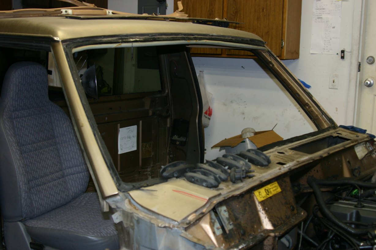

Pulled the windshield trim, need to buy an extractor for the windshield so I can remove it. I will then cut the little studs off that hold on the old style trim so a newer rubber seal can be used. My neighbor works for safelight so I can get him to reinstall it for me for the cost of beer. This will allow me to weld some of the mounts that the newer dash/steering column needs easier with the windshield out

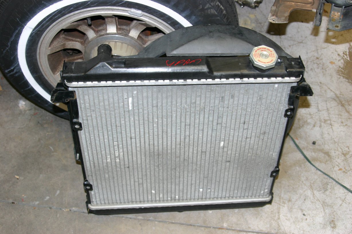

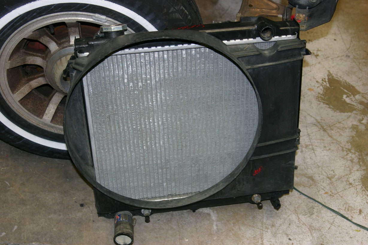

Well I had been wondering about what to do for a radiator, and the 4cyl 2.5 radiator seems like it was perfect match....unfortunatly no one seems to make a good replacement radiator for it, only single core, plastic aluminum setups. There are some all aluminum radiators on ebay, but they are single core.
Well this was all moot, I was just going to wait untill I came to that bridge to burn it. The thinking was that I would wait untill I knew for certain what I needed to use for a radiator to order one....I have a good 2 core OEM radiator here from a 2001 6 cyl, that I could use, and I have the crappy old radiator from my MJ I could use for mockup. The problem was, the more I looked at it and the more I measured the more certain I became that I would need to use it. Which left me with the problem that if I did need to use it, there would not be a good replacement option.
Now anyone can spend the time to custom mount a custom radiator, or an off the shelf radiator for something like a YJ/TJ, but since I am faced with enough fabrication already here I am hoping for something that will bolt in.
Now that being said I came across something at the junkyard that is either a windfall, or a white elephant, here we have a nearly new, single core(but thicker than a double core) OEM style radiator, $50 is a little pricey in my mind, but if it works out will be a good solution. If it doesn't well crap, I just wasted $50.
Got the windshield removed and safely stored in the basement:

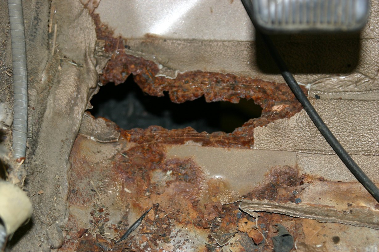

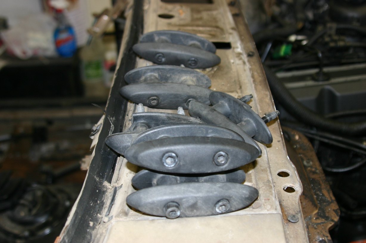

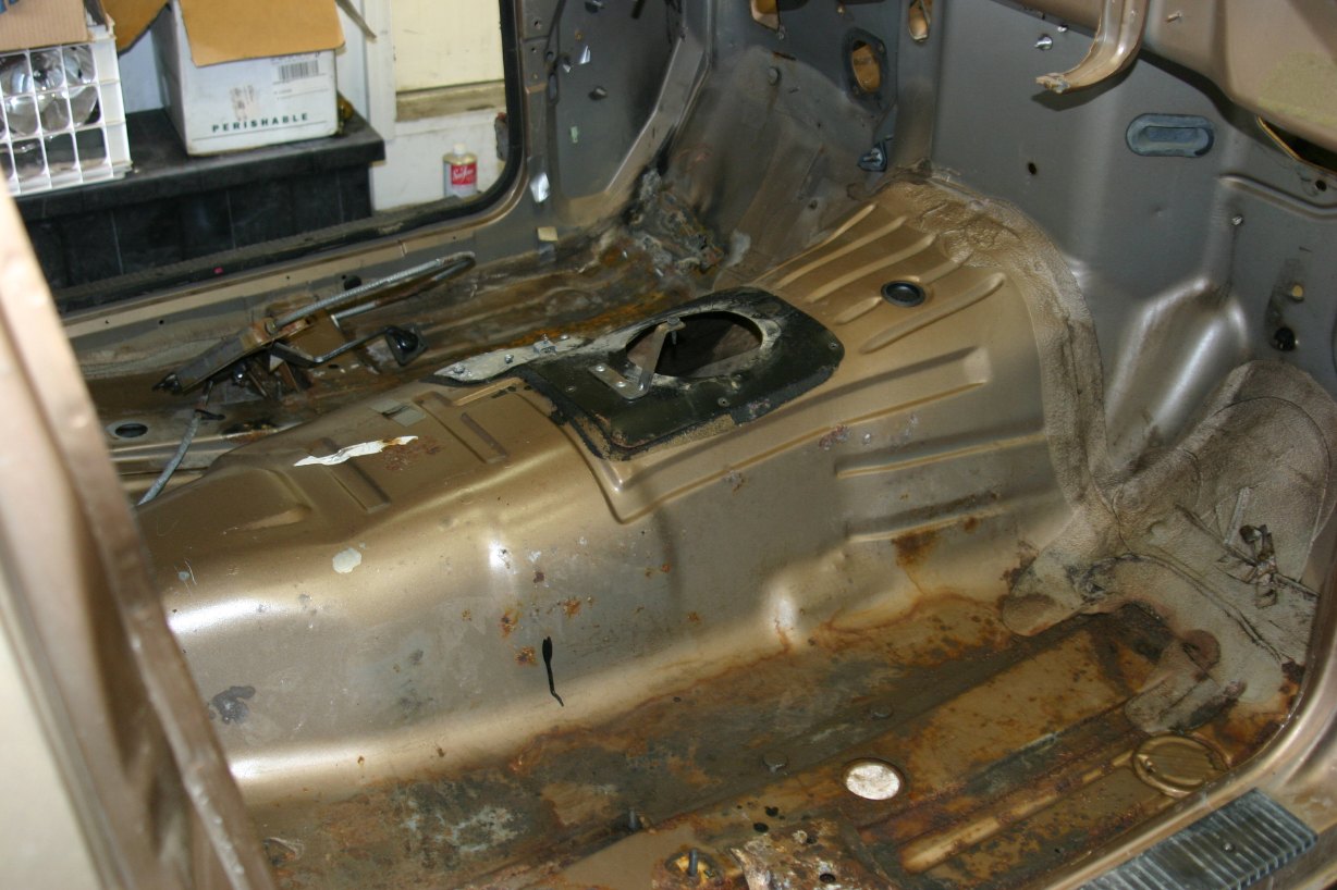

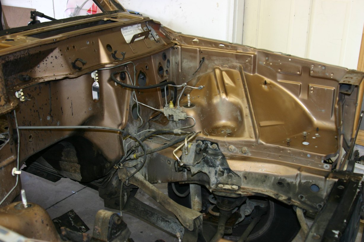

And of course further probing reveals more rust, what ticked me off about this bit was all the rust was below the seam sealer........ya, the metal rusted out below the seam sealer......grrr, oh well, I got a junk hood that I will raid for patch metal. Fun part is going to be welded in the patch panel with an Arc welder......I got some 1/32" sticks that seem to work OK on sheet metal.
I need to spend a hour or so cleaning up before I move on with work, garage is cluttered with a bunch of parts strewn around.

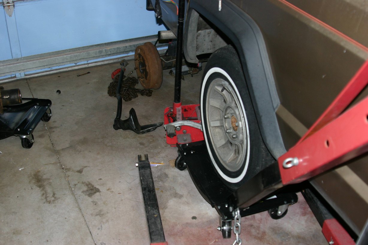

I got these dollys at harbor freight, they actually work really well for rolling the Jeep back and forth in the garage, I would highly recommend them to anyone who thinks they might be useful.
I'll second that. I have the Princess Auto version. I use them to roll my car into the corner of the garage for the winter.

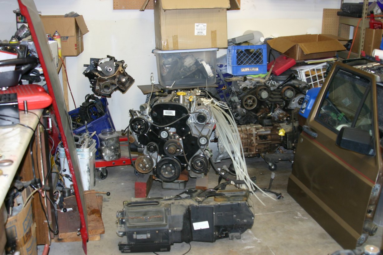

so I rolled it outside(easy to push with no engine trans, interior, etc etc) and washed out the garage and also scrubbed down the engine bay. Got it pretty clean, normally I wouldn't bother but it needs to be throughly degreased before I can shoot paint.
Still need to do some other cleanup and tear down before I can shoot paint, though I will probably wait to shoot the engine bay untill later, going to try and get most stuff mocked up, then ripped back out for paint.
this weeks major goal is the get the drivetrain in place so I can move on to mocking up the interior, front end body parts, AC, intercooler, etc.
