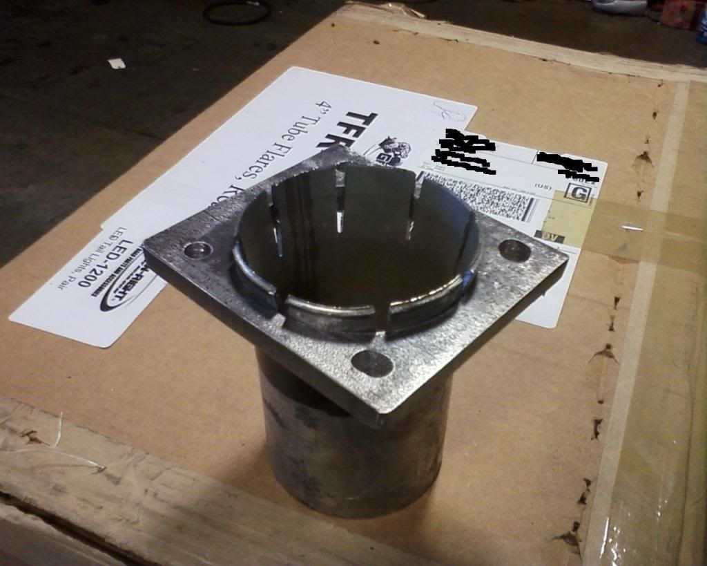

So I picked up a Thunderbird SC and have started fabbing up some brackets, mounts, and so forth. These SC's are set for 12 lbs of boost stock. Im going to have a larger pulley made(or find one) so I can run less boost(6-8lbs). The TB will be on the inlet side of the SC.

question...
how are you going to adapt an Eaton blower to a 99+ intake? and get a belt around the snout?
Removing the AC that doesnt work and mounting it on the pass. side. Similar to this, but not booty fabbed.
That may be one of the better solutions to a supercharger.
are you using the jeep TB on the SC? If you want a better looking adapter to the intake, take the blade out for the factory TB
