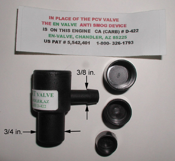

Here is a pic, since everyone loves pics!
Thanks for the post Jeff. If this EnValve doesn't work then I will try the VC swap.
