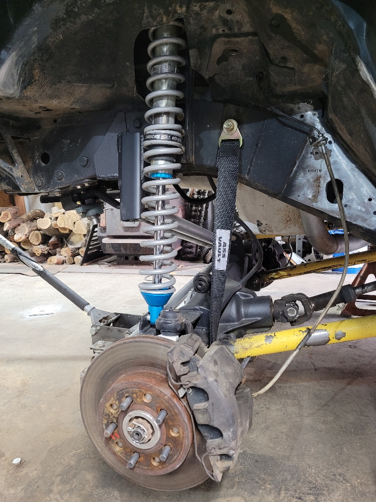

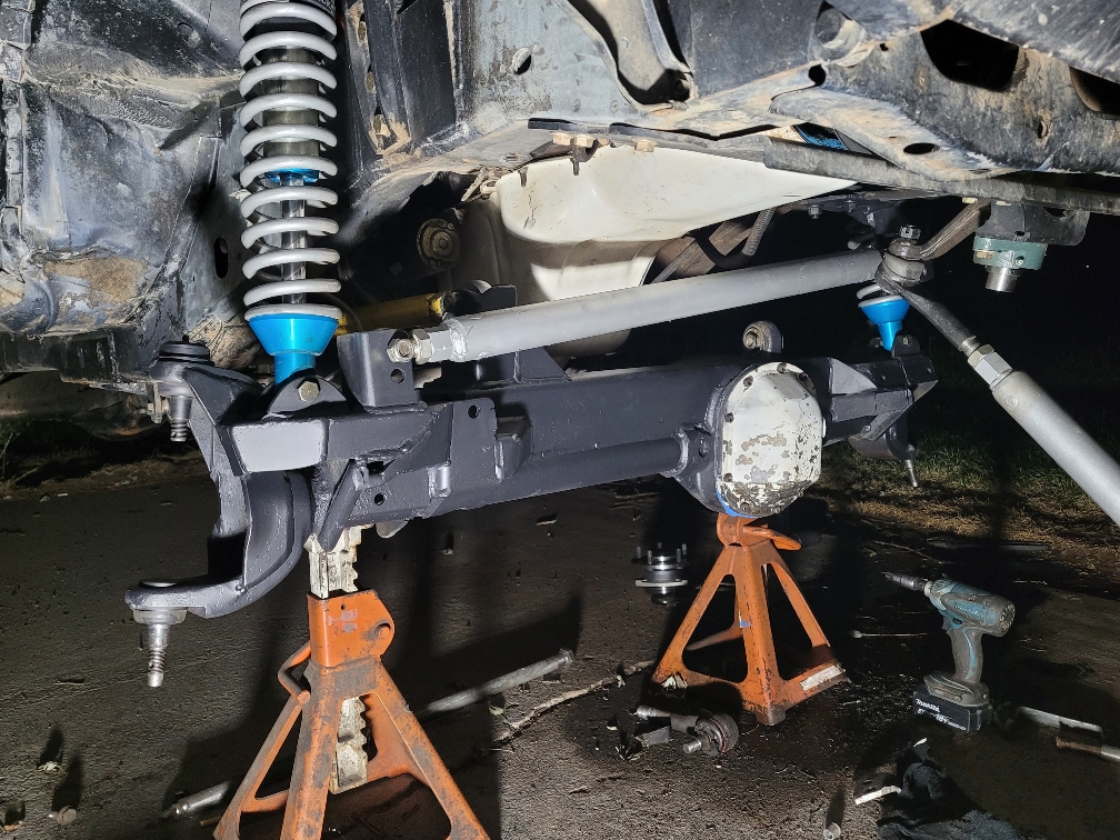

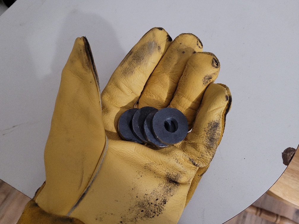

Everything is burned in on track bar last is 1/4" caliper spacers and bolt it all together

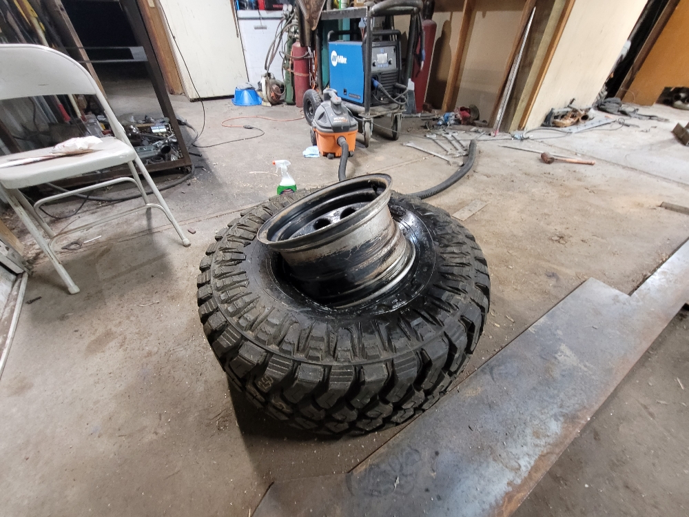

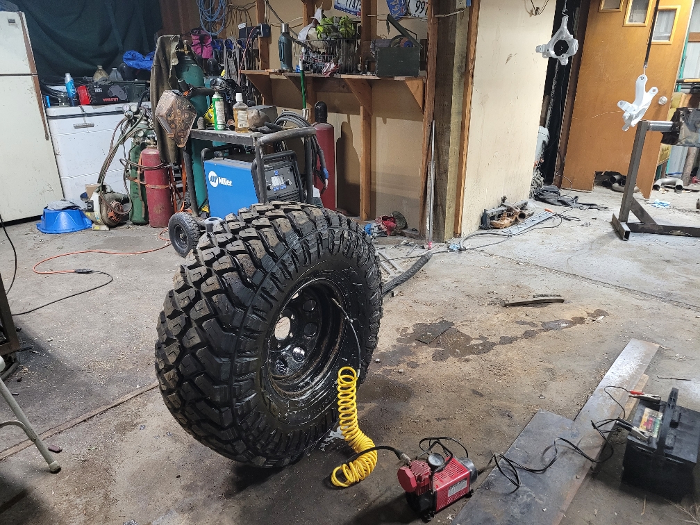

Wrestled the new tire on I've only done at tires so wanted to see if I could do this tire, yup its doable and seated bead with trail pump.
I'll be packing tire irons and plugs and big patches in the jeep now.

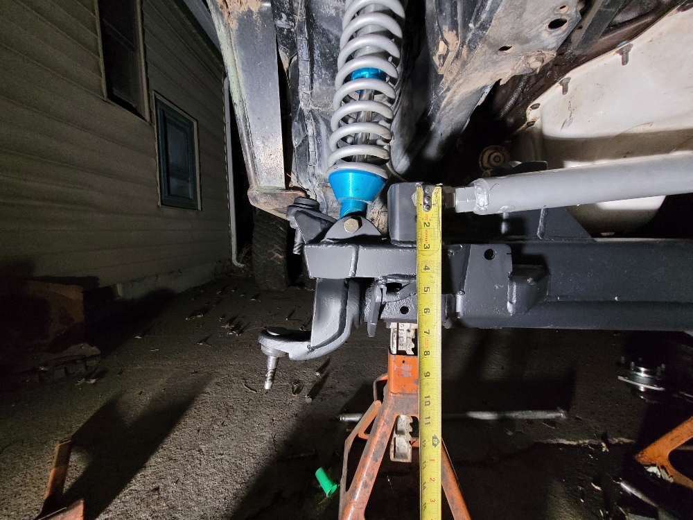

Still have limit straps to do. It never ends.

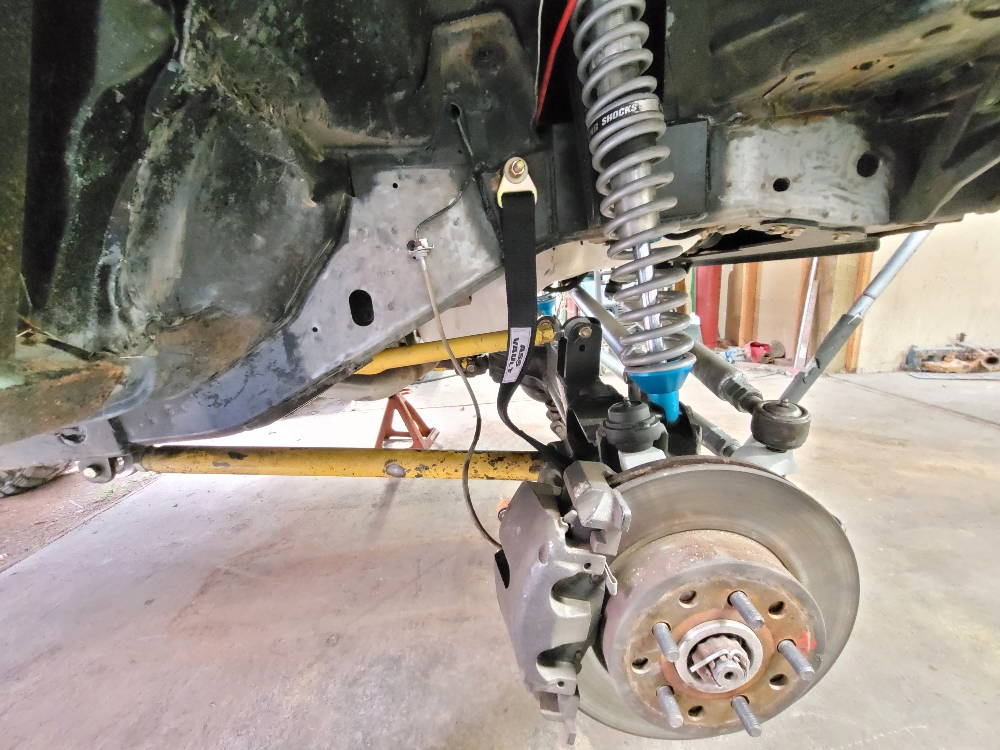

Have one side bolted together found I need longer caliper mounting bolts
Hopefully I can find some tomorrow m12x1.25x40 is i think what I want.

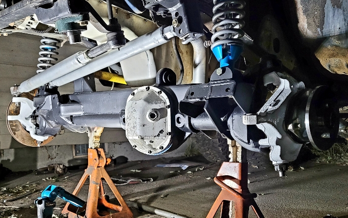

I got a say this is rewarding. Not much of the xj left on the front end
I've gotta ask evan... all this work into a dana 30... does it worry you? They seam do decent on 35s but can't really be beat on in my experience...
Sent from my SM-A426U using Tapatalk
Yes it worries me.
Hp44 is 500. Dana60 alot more, super duty 300 and zero axlevtube to build on my time to revisit this all again priceless.

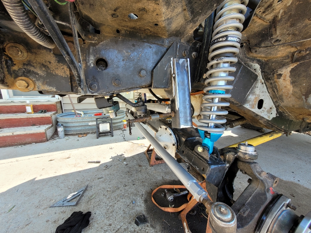

Which steering brace did you go with? I know hydro assist takes pressure off of the gear box... so maybe it isn't needed. I like the idea of a hidden winch/ steering brace tho. Badadfab comes to mind
Ironman

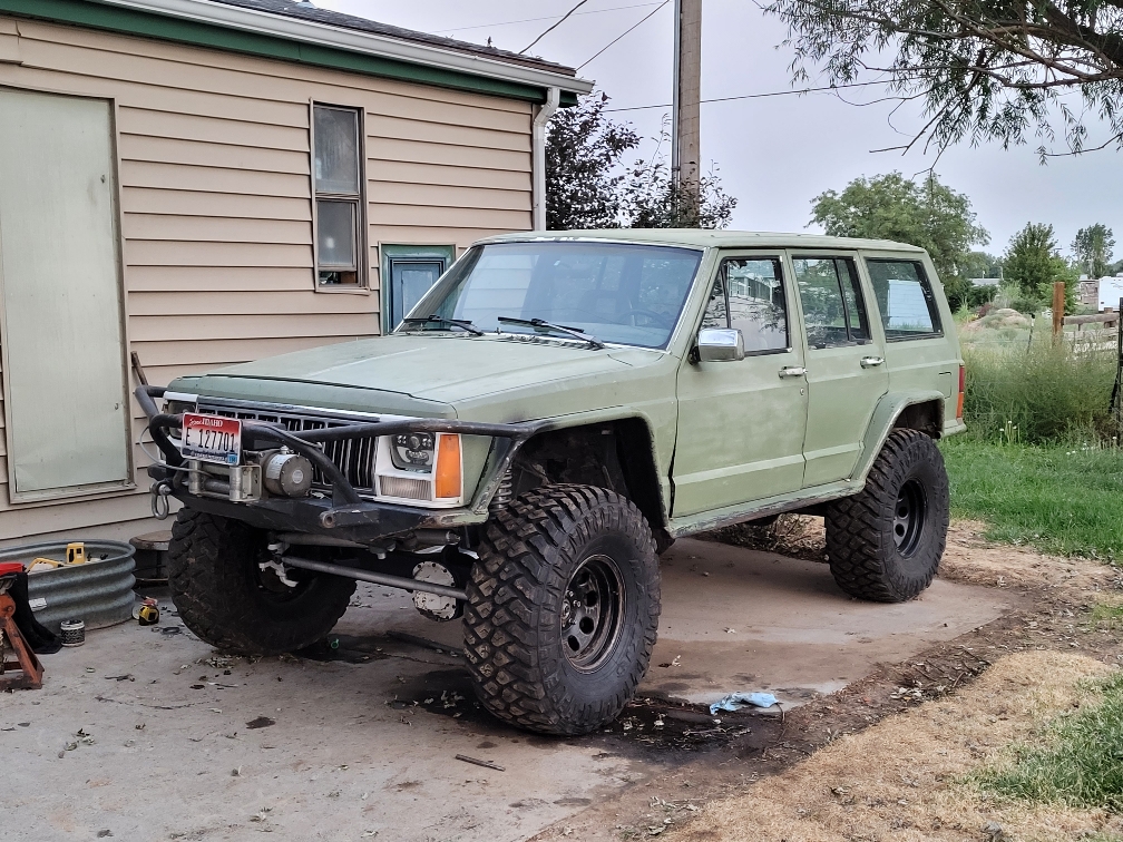

Drove around the block and nothing bad happened. Need to center wheel and run it.
Straps on. These will make me feel much better. Have them set1" from full extension hoping they stretch to 12". If they stretch passed will raise again
Just welded bolt on.

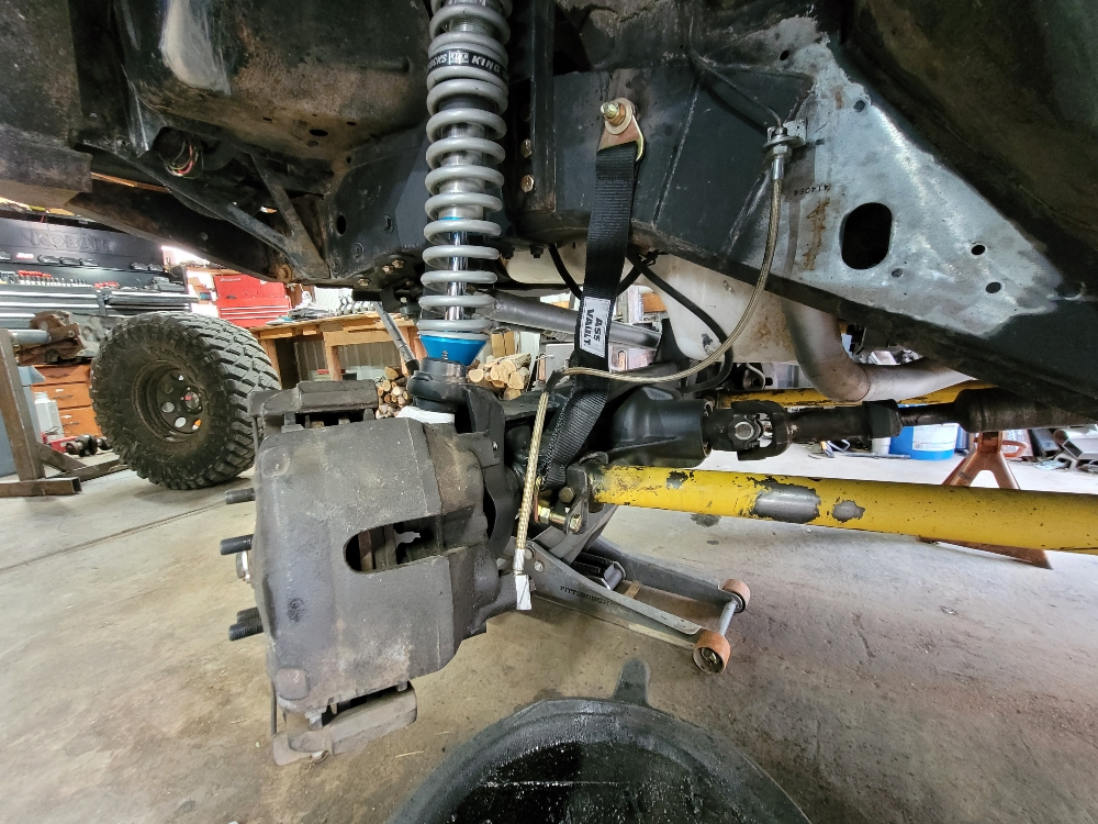

Ground caliper so could orientate banjo fitting up.
Headed to the store and a quick shake down. Also centerd steering wheel. Well closer to center.
When you upgrade to the akebonos, I highly recommend the powerstop refurbs that come powder coated red. If you go through 4wp there is no core charge or return. (Feels like I've shared this more than a few times but still!) I've heard of others taking in the teves for cores elsewhere and getting denied due to them clearly not being the same.
Both cleared my 15" steelies. Aside from the design to stop warping rotors, I also like that the akebonos have the little aluminum slide thingies, spacing the name.. where the brake pad rests on the caliper? My teves had little notches top and bottom on both sides, that is common for even stock xj calipers, that can be fixed with weld but I'd just as soon not worry about it again
I was thinking about upgrading. When I picked these wj parts I picked the rig that had what looked like the best rotors. No lip and had thick pads.
These are braking well. Though the caliper mounting bolts backed off. I've already orderd longer bolts I couldn't find them local. So looks like the waiting game again.
Driving around town this thing feels all around more solid brakes better steers better and I think rides softer. Almost feels taller to.
Less clunks and noises to.
Ohhh the best part I think axle seals might actually be sealed in the front.
Going to have to address lighting soon. Most the corner markers are gone after the last adventure.
