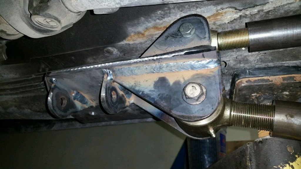

This is a full on 4 link long arm. Like i said, it's not on the site yet. Mine is the prototype. It was built and engineered to be used on. As short as a 2" with zero interference issues at any point of compression or cycling at any other point... How could it get in the way of the pinion when the arms go above and next to it? This was designed to clear the floor, exhaust, and frame rails. Which are the only things that would be of any problem with clearance...
I'm having a hard time picturing how that's going to be packaged without cutting the floor, hanging really low, or having terrible frame side separation.
Thanks Will. That's the only picture I have of it right now. That's from when they were almost done with it on the mockup Jeep. It's going to be at my door tomorrow. I'm hoping to have it installed in the next couple weeks. I'm still recovering from the accident, dawn whiplash, and stupid drivers...
You can see how the lower arms are inset of the rails, not under... No clearance issue with the rail, and it clears the exhaust and driveline easily...

looks good, im just wondering about the joint separation on the frame side as there are 6"-8" (i think) separation on the axle side
