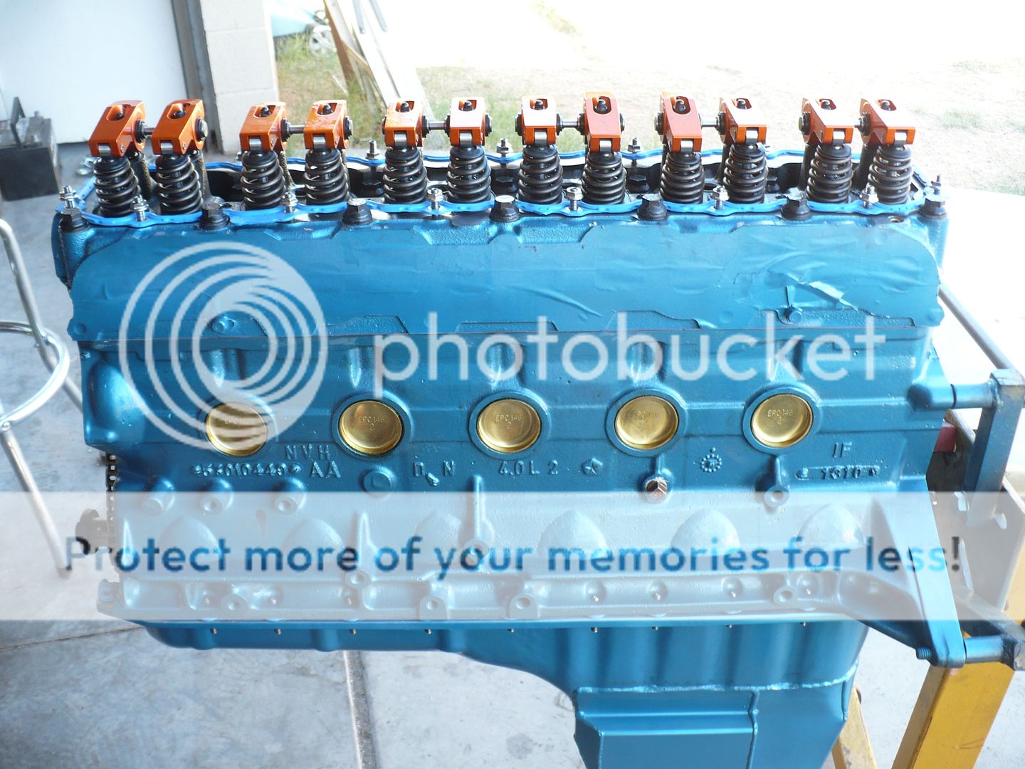

The Harlandsharp rockers are the same as the factory ones (1.6) and they install exactly as factory they are desinged to work with our hydraulic lifter cams. I started with HS rockers on my own 4.6 and did end up getting some new pushrods to get the proper lifter per-load before I installed Scorpion 1.7's. I started with a 2000 factory valve cover before going to a aluminum cover.
Thanks for your reply.
I like the looks of those Harland Sharp ones. They look familiar to those on the 500 CI Chevy blocks back then. I did remember using some stainless-steel ones also.
When adjusting them, did you turn them down 1/2 turn after 0 last? I did remember 3/4 turn for the regular guys and 1/4 turn for the go-fast crowd. There were also some solid lifter guys that had about 0.010 lash.
Just to be clear, the Harland Sharp roller rockers will fit under a factory valve cover without requiring the use of a spacer or any other mods?
