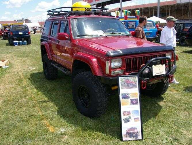

That is good to know. I really like my rears, so I will be buying the fronts. I put lock washers on mine after the trial fitting because I had a nut bottom on the bolt. He supplies all stainless hardware with the flares.
I run the Napier flares, wouldn't change a thing.
I really like these! Got any pics of what/how the cutting went down?
I'm not fond of the pocket flare look, preferring something that provides a cleaner line, while offering tire coverage. The BW Flatties have worked well for me. I like them painted to match, I've had several non-XJers comment about how they like my factory flare option better........:shhh: For reference, I'm running 6" of lift and 285/75/16 tires.
I too don't view my rig as disposable and was concerned about introducing a potential for rust by notching the wheelwells, per BW instructions. For this reason, I added an extra couple of steps, taking the time to weld the notches back together and then primed/painted the area to minimize rust.

The rear flares have held up to a rock-kiss or two, but if true durability and protection is your priority, fabbing a set of tube flares that are similar to the BW flatties and incorporating them into reinforced quarter/fender armor (JCR?) will give you the best of both worlds.
I freakin' love your rig- I'd like to see a pic of your finished rear cut/fold/weld job. I'm still not too fond of the BW flat flares, but they look good with the matching paint!

you have to cut and fold the rear to match the front stock opening (which is larger) just mock the front flares up to the back cut them to match the body lines and then mark and bolt them on. it took my no more than 2 hours to do both sides and no-one has ever thought it wasnt stock.
my buddy was going to toss his flares and i literally pulled them out of his trash can. so Free front flares reversed and notched and they were good to go
