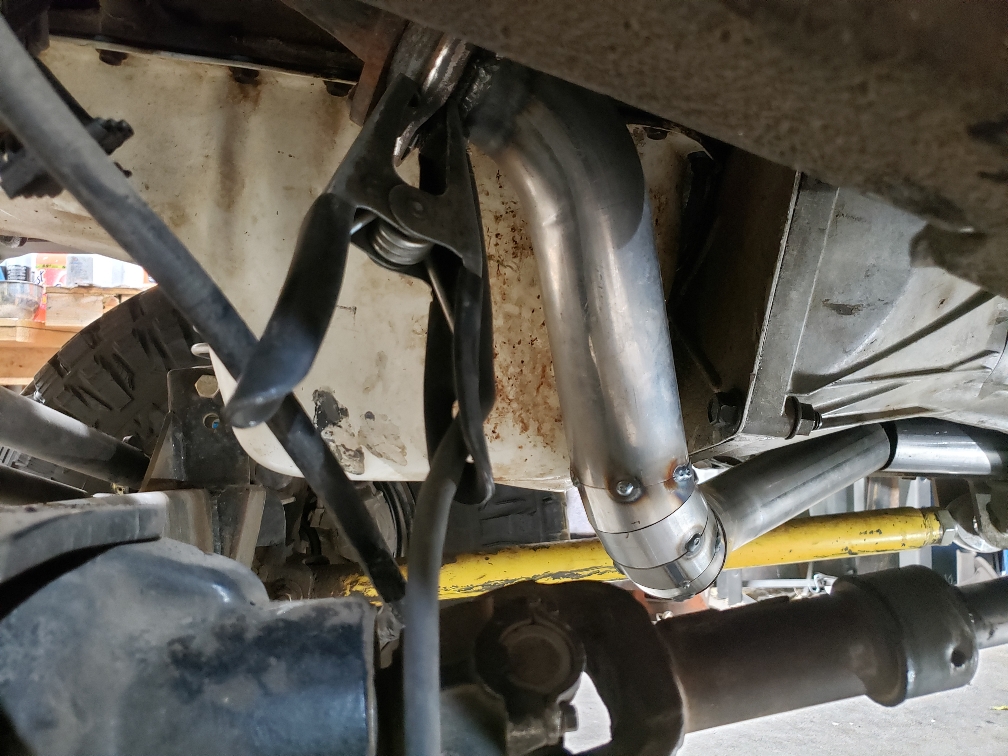

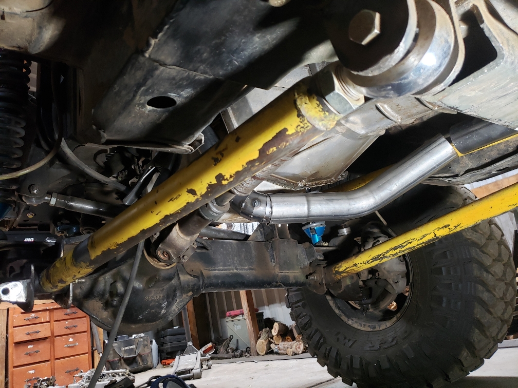

Started plumbing not quite through the trans crossmember and in the clear yet.
Gained lots better driveline clearance
Kept the crossover above the control arms theyre about the only protection the exhaust gets.

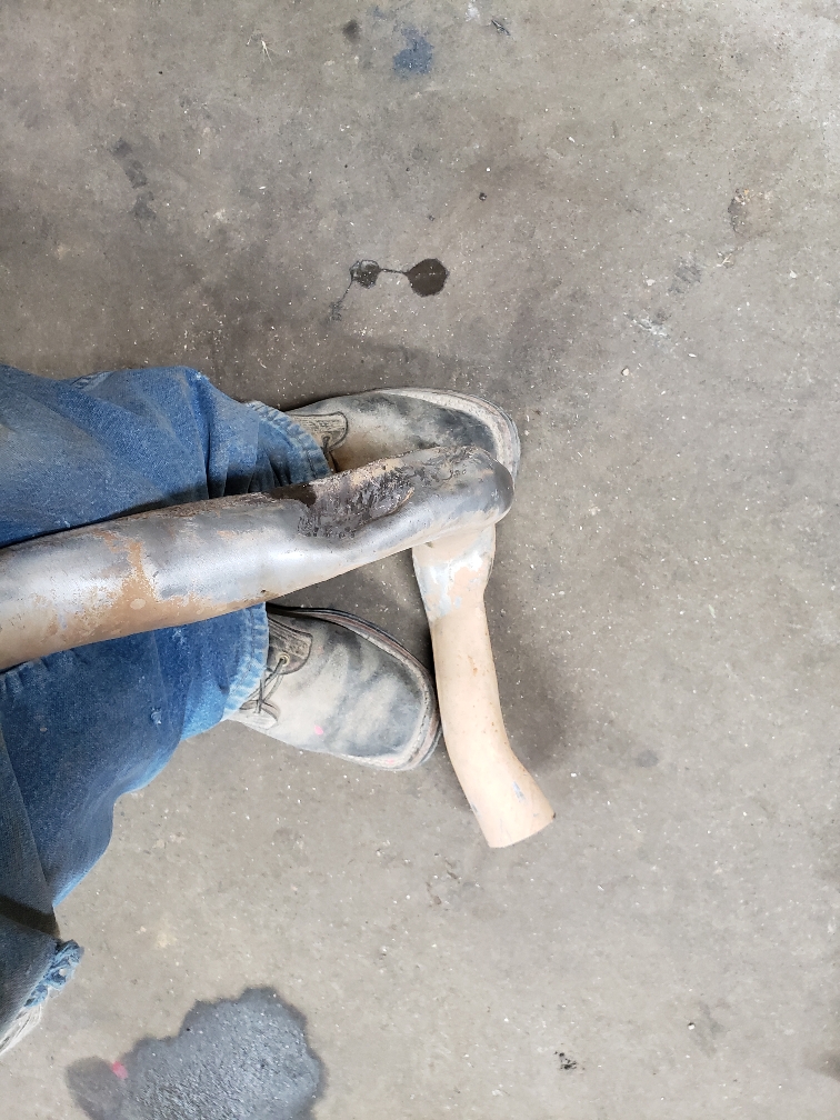

Last pick is stock pipe thats been beat up by driveline and oil pan.

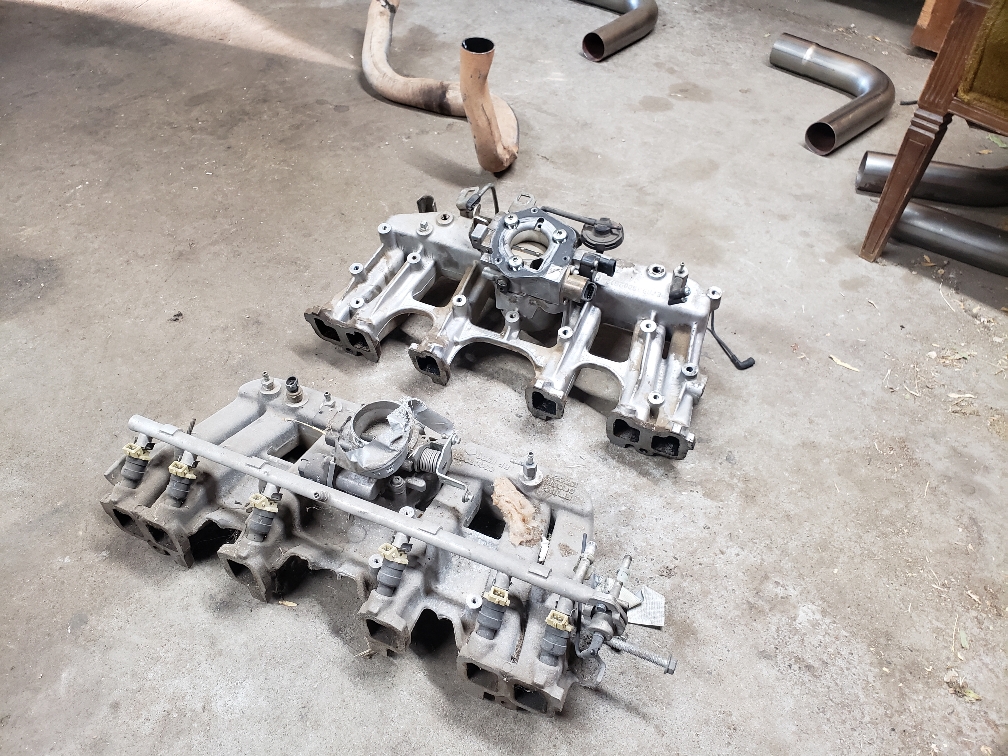

You have an HO 91-96 Intake and a RENIX intake pictured. I was going to offer to bore the RENIX TB, I think I have. I have been boring out some 4.0L TB the last few weeks. Just to the 60mm. I did the last 3 with a taper at both ends. Actually, the inlet side has a cast taper. I machined that. It was actually causing me issues, as I could not dial or center the bore. Then I chucked on the outside. I might have an HO to spare, if you haven't bored one out. It would be interesting as to what performance it gives.
I will note on my '98 XJ with the 99+ intake and 2.5 exhaust, I did notice better performance on some hills or inclines. I can't remember which injectors I was running. I think the Ford 4 holes. Presently, I am running the 12 holes. On the RENIX, I hear the Volvo is the injector to use. Also, some use a Neon 1-hole injector. I don't have a clear view on this.

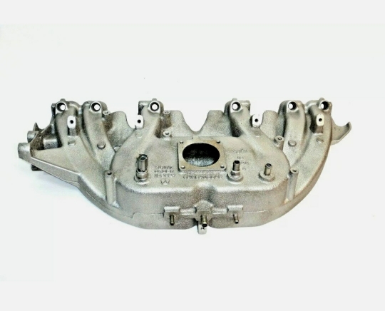

Your top intake manifold is a RENIX 87-90. Bottom HO 91-95.
