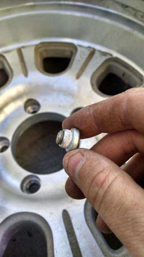

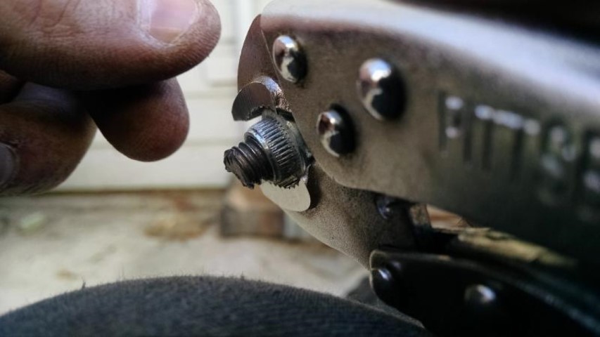

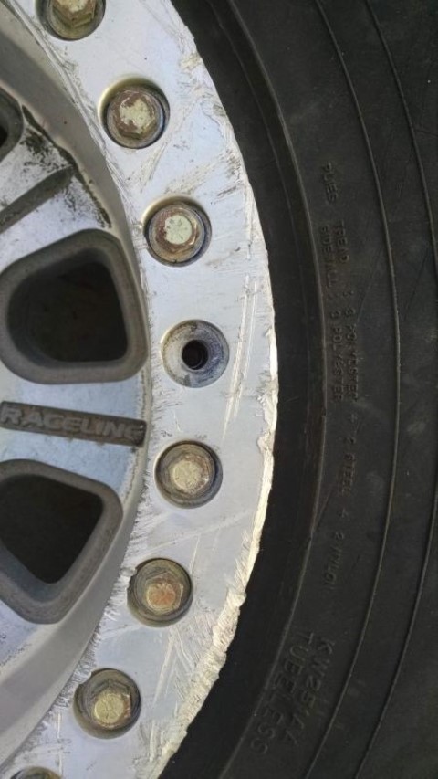

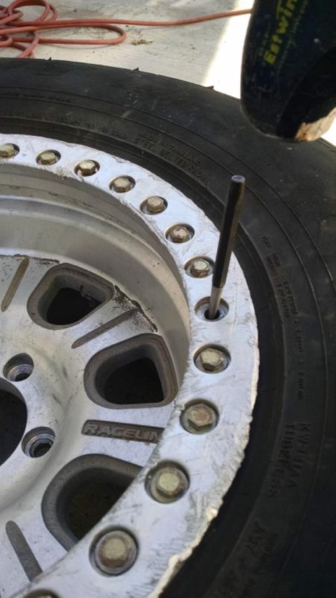

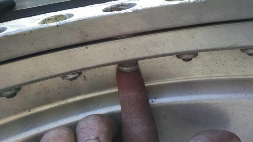

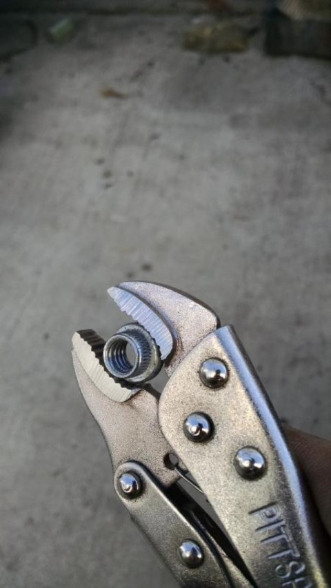

One of the things every beadlock owner hates to deal with is broken bolts. It happens. It sucks.
Its one of the places that Raceline wheels *really* shines.
The bolt threads into a nutsert. Grab a punch and just punch it out.
Once its removed, the threads are relieved and you can just unthread the broken bolt with your fingers.
Push the nutsert back in the hole and run a new bolt home.
If the insert were damaged, Raceline throws a couple of spares in every box, and they are pretty good about just giving you a few if you call and ask for them.
Maybe not super high end tech here, but more exciting than just saying "I changed tires today". ;)

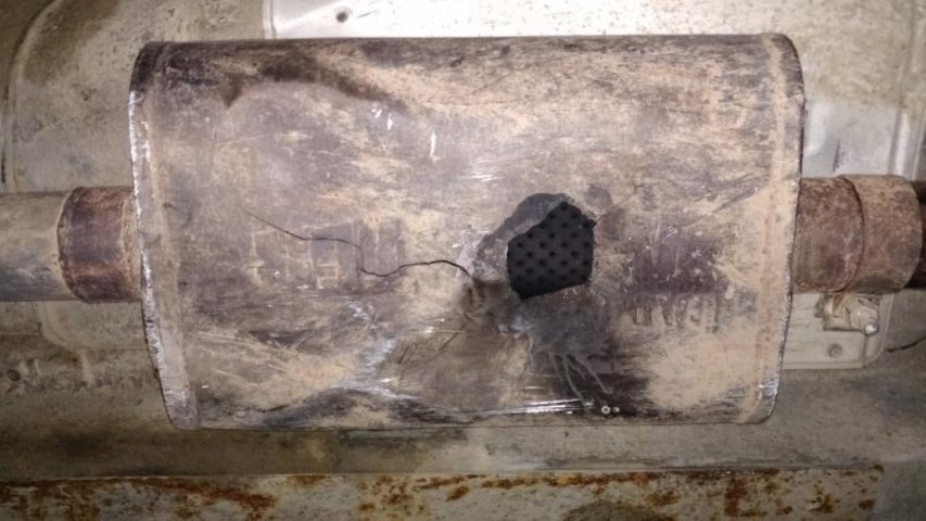

Alrighty. It looks like its time to buy a new muffler. Looks like Banks isn't interested in giving me another one (these things aren't cheap..).
Thoughts on what we should look at? Magnaflow? Flowmaster?
weld a 1/4" plate on the bottom of that one? Then you wont be buying a new one every 2 yrs or sooner. It will be rock proof :)
