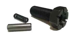

I'd replace it. Cloyes and Summit sells the bolt, spring, and pin
as a kit.
This one? It certainly looks like it could be that pin.
