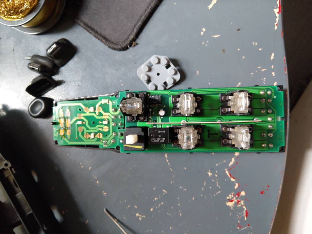

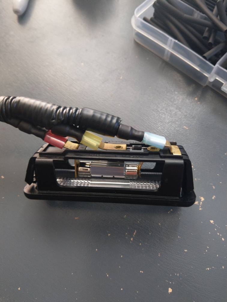

I finally got some time to do some more work on the truck. I focused on getting the interior finished up. The solder joints on the drivers side switch panel were all redone. Now the passenger window can be operated from both sides of the truck.

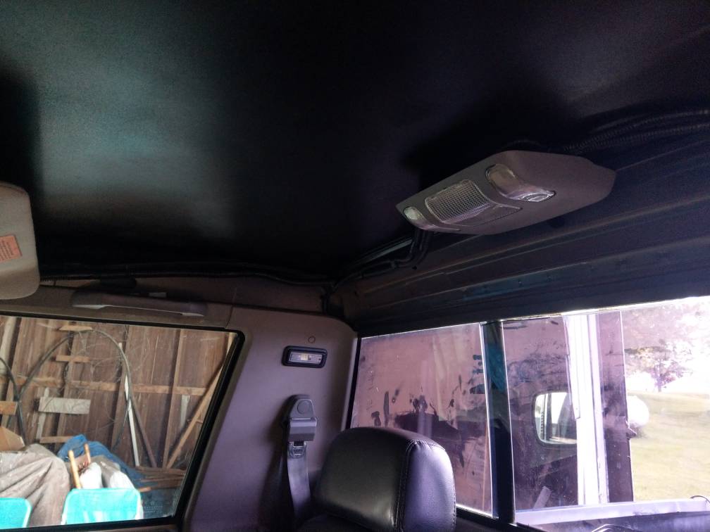

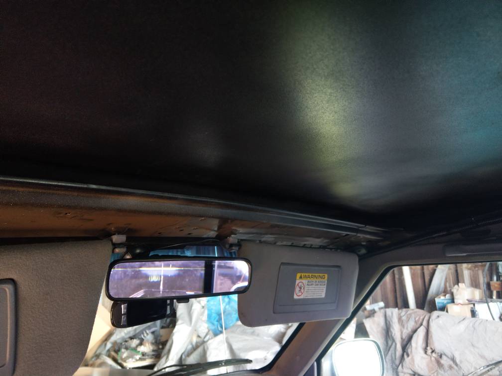

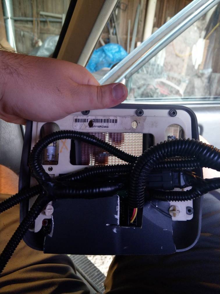

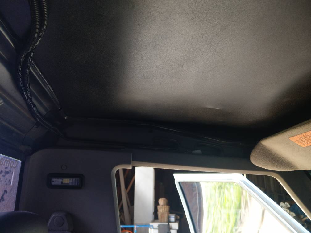

The biggest change is that the headliner is no longer in the truck. It started to sag and was really annoying so I just took it out. I forgot that I had bedlined the roof and it looks better without the headliner. I plan to leave it without one.

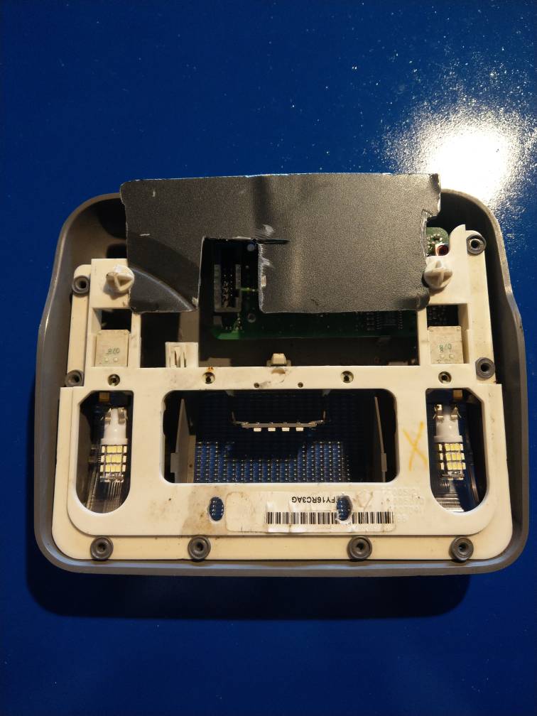

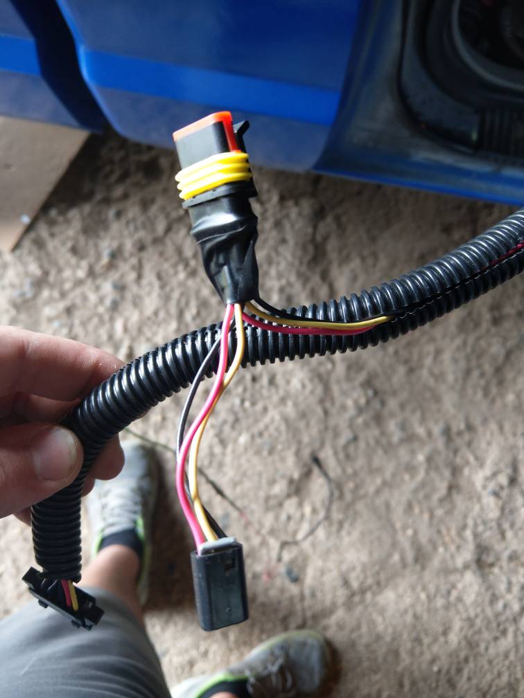

Since the headliner is out, the dome light didnt have anything to attach to so I had to relocate it. I took advantage of it being apart and modified the factory wiring harness to tie in my b-pillar lights. It now has all the interior lights in place and functional. They were all also swapped to LEDs except for the floorboard lights.
I was able to reuse my bracket I had made up to attach it to the headliner. Now it is just clipped over the inner roof sheet metal and doesn't move. I can pull it off easily if I need to and just shove it back on with no tools. The wiring is visible in the cab but it's all split loomed and tied nicely across the back of the cab. Since the dome light and wiring is all run to the back, I can use the holes up front between the visors to mount a CB whenever I get around to it.

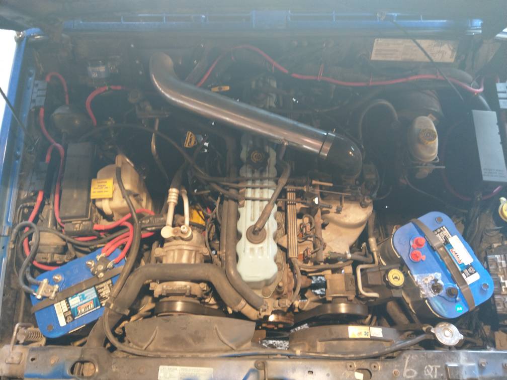

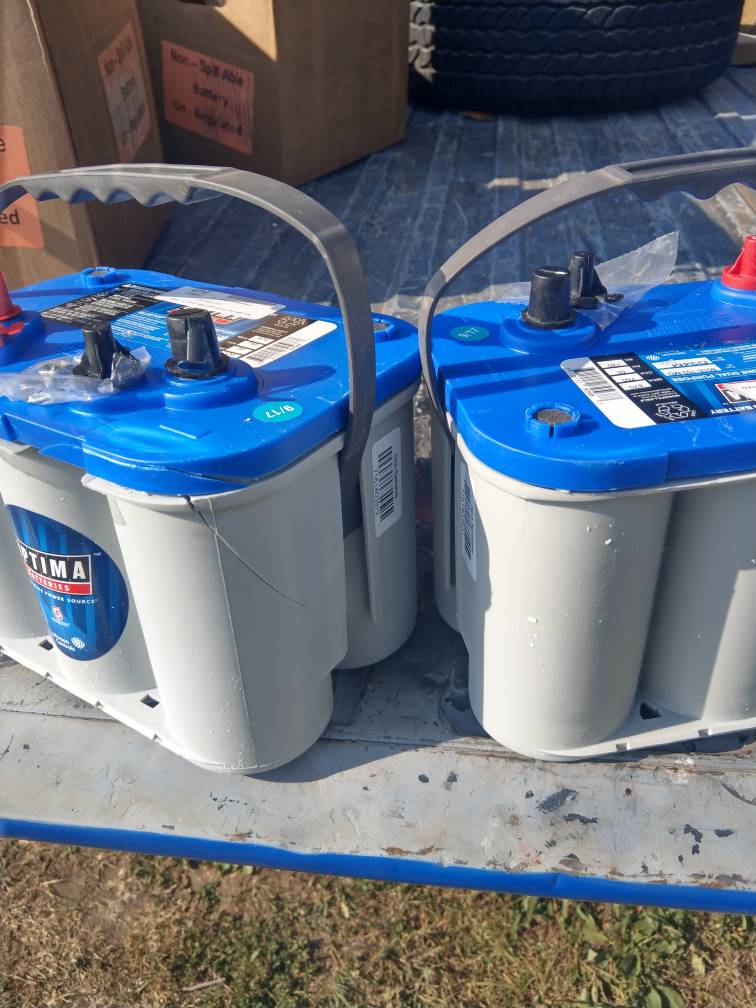

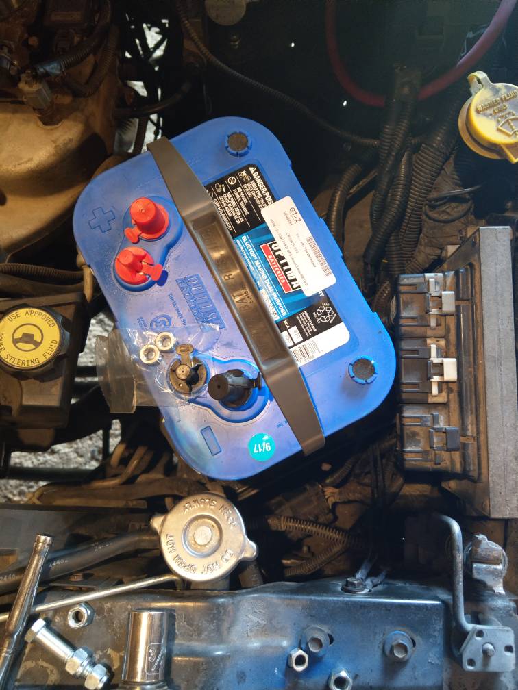

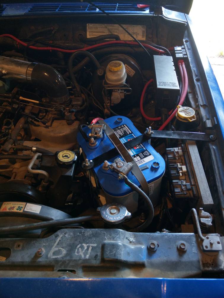

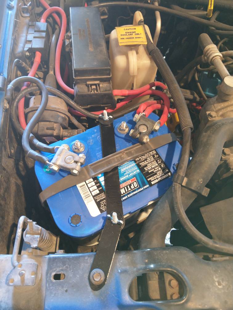

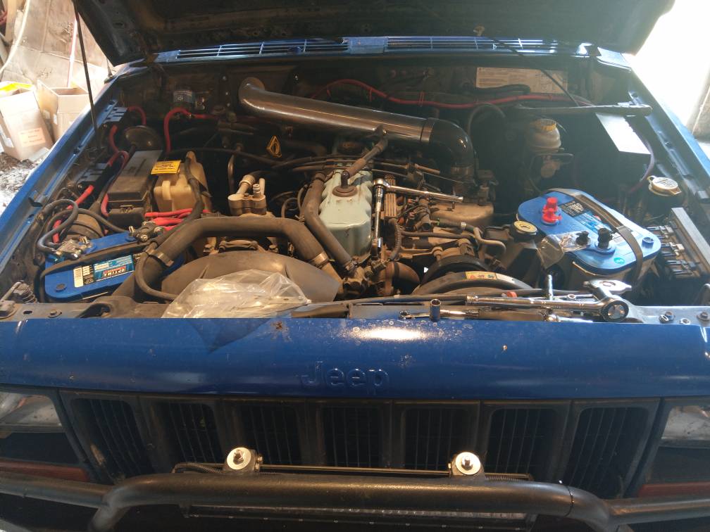

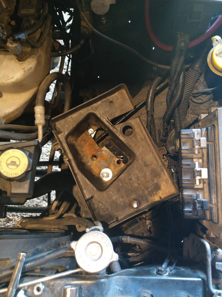

Well I finally got around to doing the dual battery setup. Unfortunately both my Optimas were dropped in shipping but Amazon refunded the whole purchase price and let me keep them. One is cracked and one has a small dent. I'm going to use the dented one and get a new one to replace the cracked one.

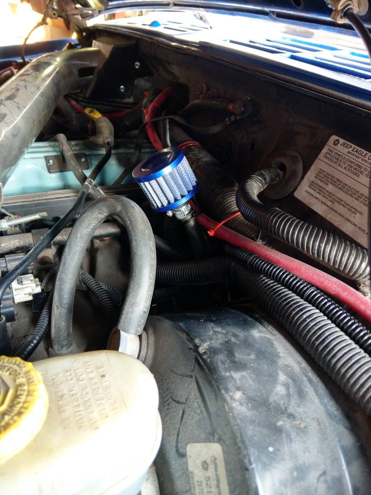

As for mounting in the truck.. It took some time and back and forth marking and cutting the tray until it fit. The battery has about 1/2" of room between the power steering fluid res, the rad cap, and the plugs on the PCM. It sits slightly higher than I want but it clears the hood so I'm fine with it. Making it sit lower would require some major modification of the inner fender or moving some components around but I don't want to do that. This weekend I will be getting the replacement battery, wiring it up, and making hold-down brackets to keep both batteries in place.
Thanks to DigitalBman and everyone else for the input on the dual battery setup over on the DIY dual battery thread. The info was instrumental in making my setup work how I wanted.
Sent from my HTC U11 using Tapatalk

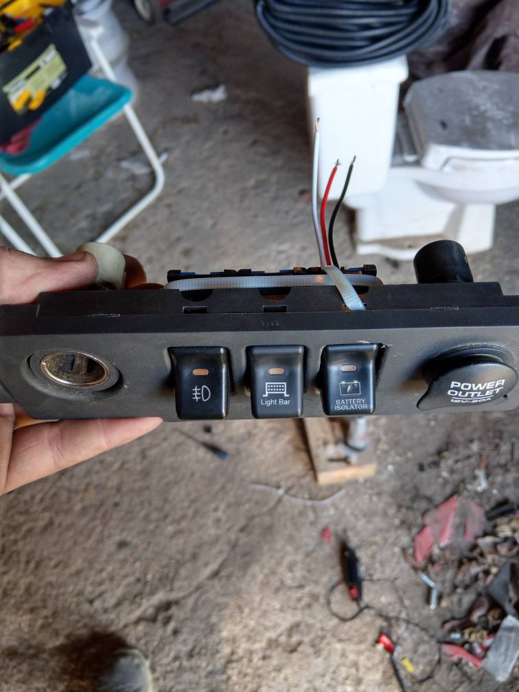

More progress has been made. *I got a new battery to use instead of the cracked one. *Got everything wired up and installed. *It took all day but finally everything works how I want it to. *I also made some battery hold down straps out of some flat steel, these things don't budge with the exception of flex in the plastic trays. *

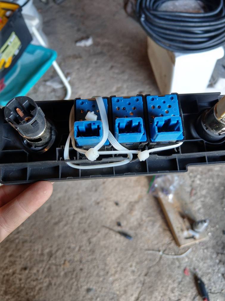

The third switch is held in solely with zip ties. There is no bracket behind the blank plate on these so after cutting it out, the only ways to attach a switch I could think of was glue or zip ties. I wanted to be able to remove the switch so zip ties is the best option. It doesn't move at all so it should never fall out.

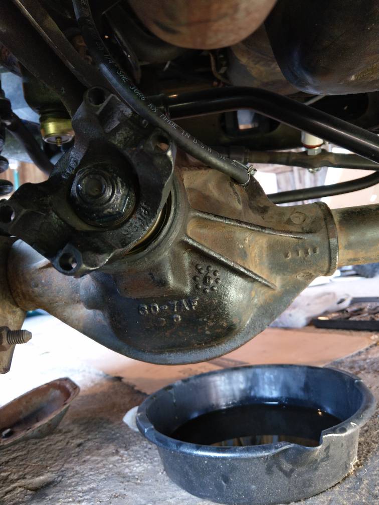

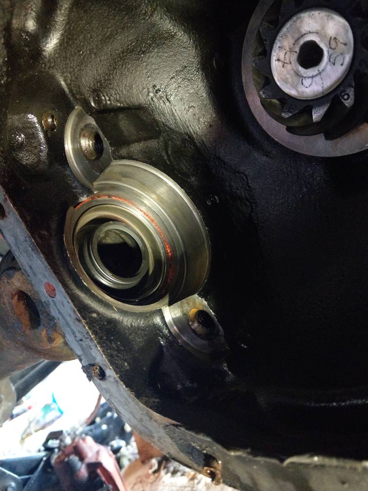

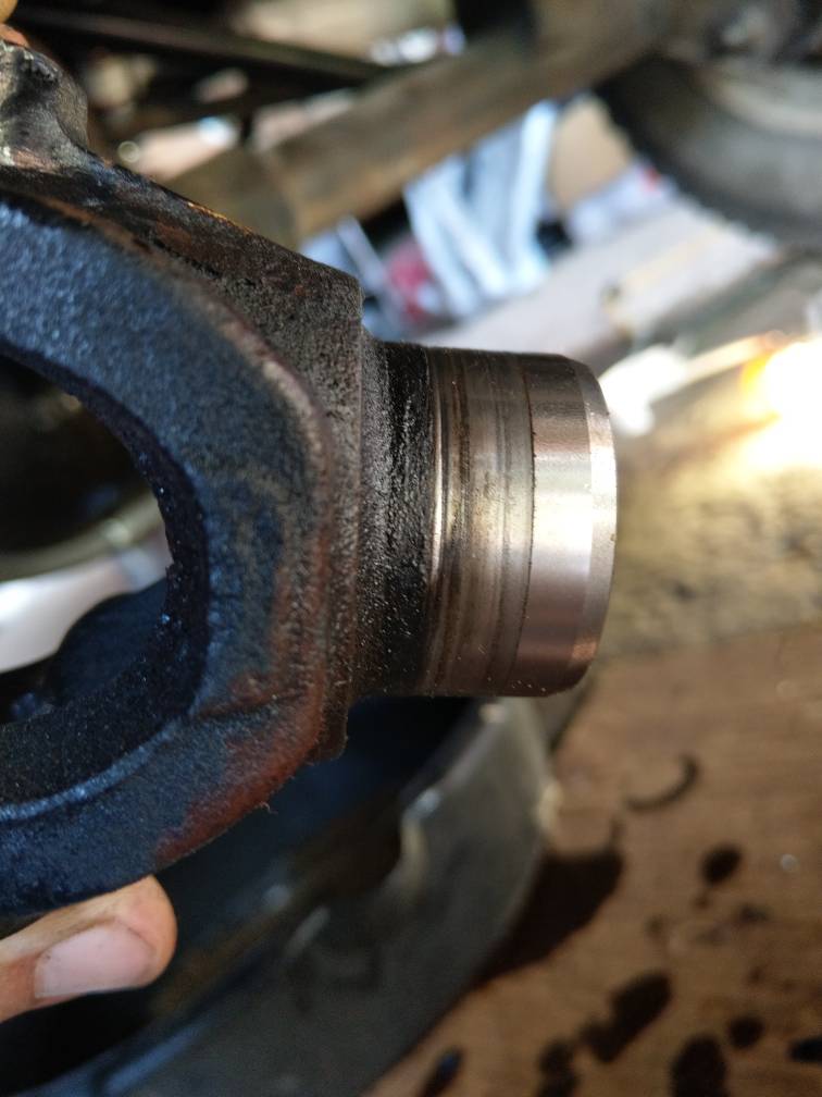

I went ahead and changed the oil last night as it was coming up due for it. *While underneath pulling the drain plug I noticed the entire bottom side of the front pumpkin was covering in oil... The trail led right up to the pinion. *I knew it had a small leak but it apparently turned into a little more than that. *I pulled the plug to see how much oil was in it and couldn't feel any. *1.5 bottles of gear oil later it was filled. *I'm hoping I didn't do any damage driving with no gear oil for who knows how long. *It isn't making any weird sounds so I think it's okay. *
I spent the last few days sorting out my front diff issues. I pulled the cover and found it to be some kind of thicker "upgrade" cover held on with an entire thing of rtv.... It took forever to get it off.
I sprayed out the case and the gears all look good and there was no metal so I think it's all OK. I did however notice light shining through the back of the diff... Turns out I had no vent tube anymore. I went ahead and ordered the proper size socket for the pinion nut (1 1/8"), a 1/8th npt tap and fitting to replace the missing vent, some fuel line for the vent hose, and a small filter for the top of the hose (the filter had to match everything else). That all arrived today from Amazon.
After tapping the vent and replacing the pinion seal, I ran the vent hose and put everything back together. It was a very straight forward and easy repair. It's now all back together and doesn't seem to be leaking. The yoke had a groove worn in it where it contacts the seal so that will probably need replaced at some point.

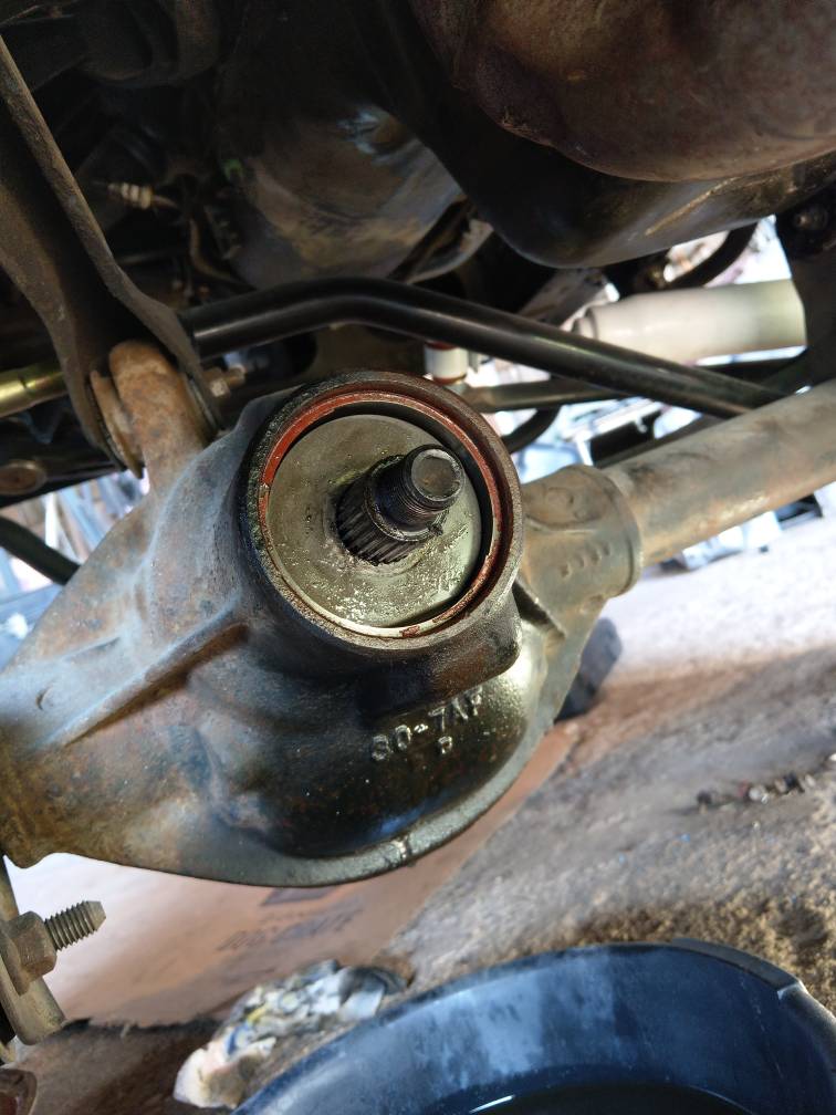

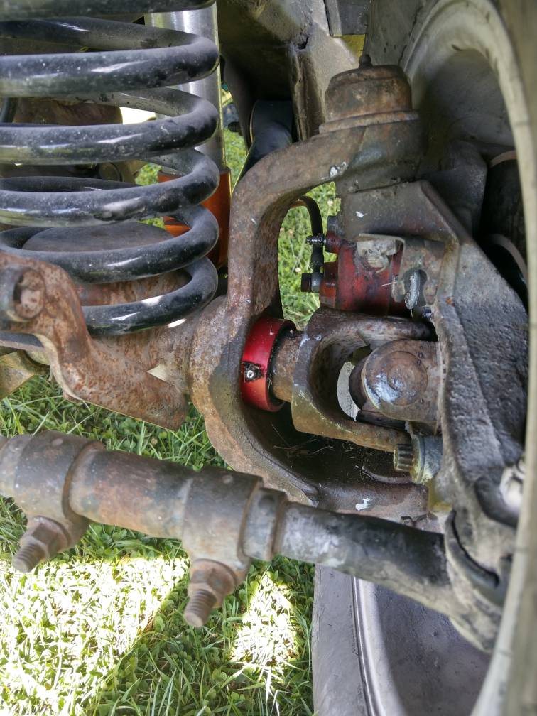

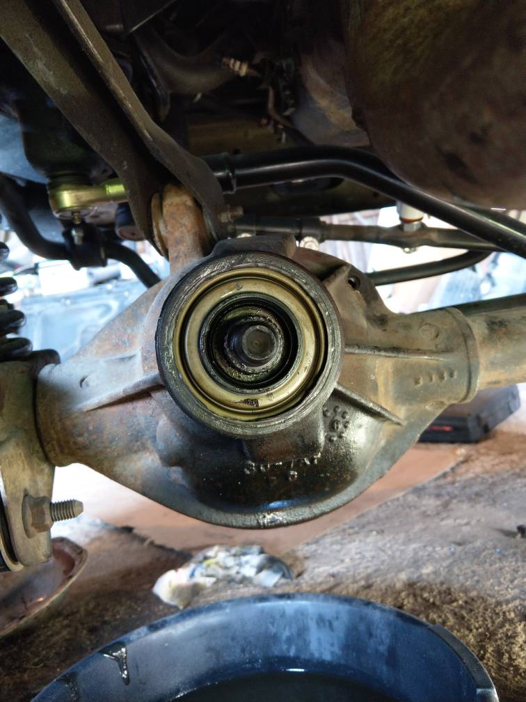

Well my usual luck struck again.. On my way to the Jeep show I started getting banging noises over bumps and found a fluid leak at the end of the Dana 30. *I chose not to run the truck in the event so I could figure out the issues without damaging anything. *
Turns out my front driveshaft contacts the exhaust. *It doesn't make much contact with it but it's enough to make a terrible racket, similar sounding to grinding gears on a standard trans. *

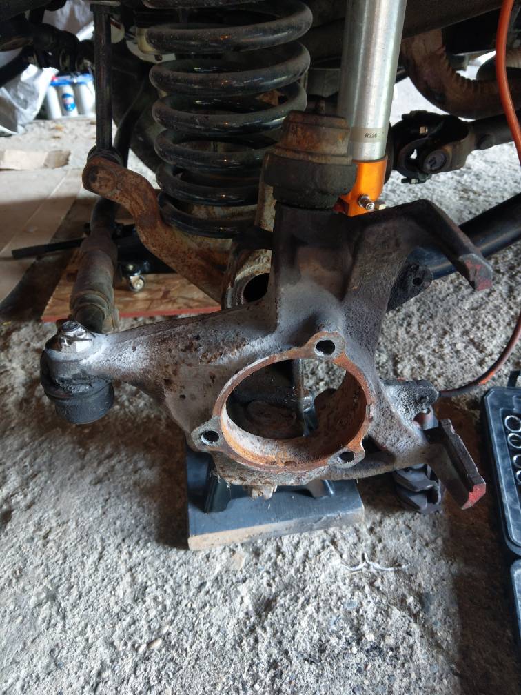

As for the leak, I initially thought it was coming from the caliper but on further inspection I realized it was coming out of the axle tube. *So after just redoing the pinion seal and servicing the diff, I have to pull it all apart again. *So far I've got the drivers side shaft pulled but the passenger side hub bolts are full on seized. *I'm waiting on a 12 point socket and swivel to use my impact to hopefully break them loose.*

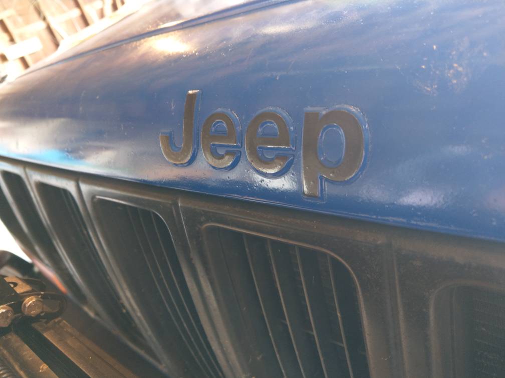

I am still waiting on my new seals to show up but I finally received the front clip stickers from Spencer. He did a great job making these based on some rubbings and pictures I sent him. The lower part of the J is just slightly short on my set but he knows about it and tweaked it so any future sets he makes will be perfect.
If you want a set of these for your 97+ front clip (they go right onto the factory lettering) get a hold of him and he'll get you some.

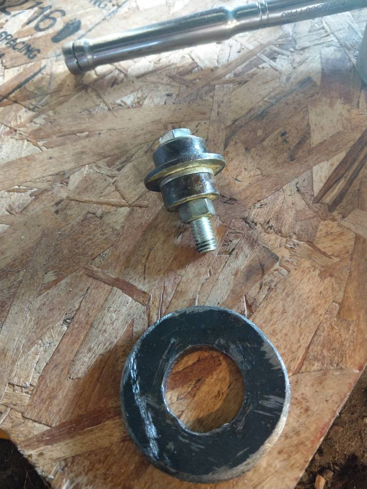

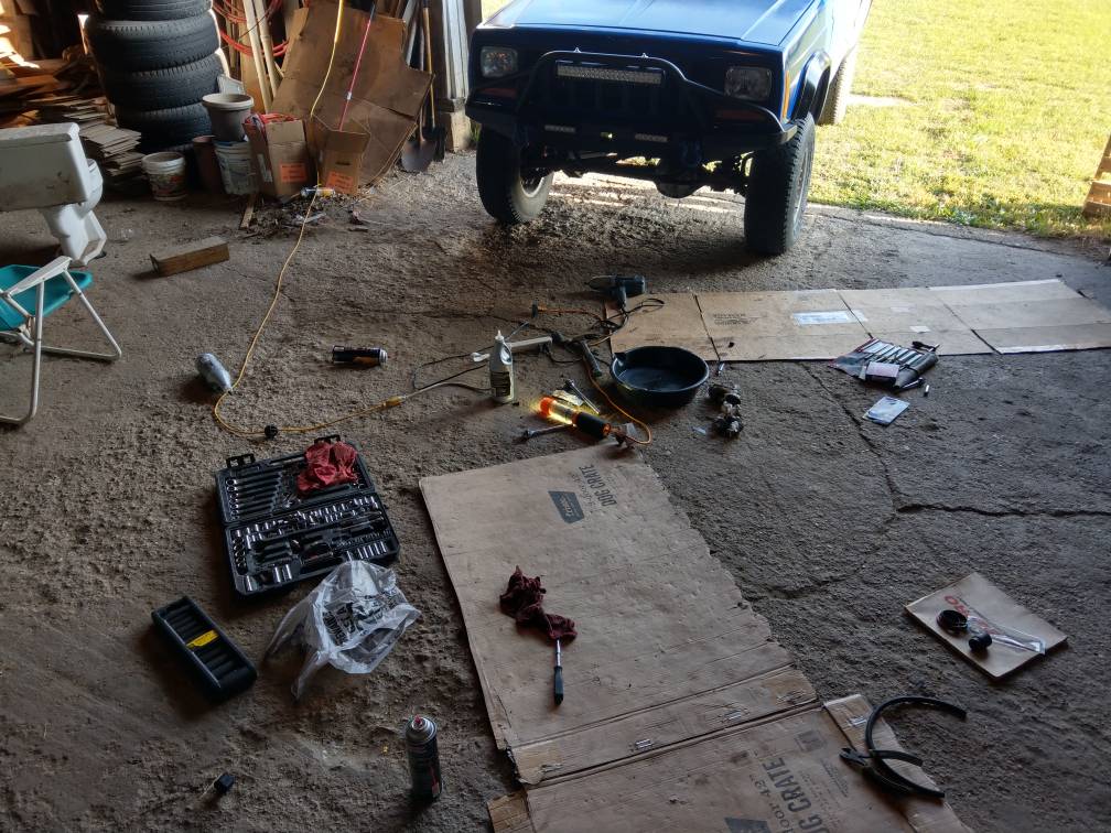

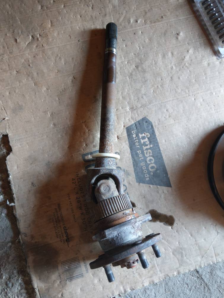

The new seals finally showed up and I started really tearing the axle apart last night. I got up to the point I was putting the new seals in and just couldn't find anything around that was the right size to use as a pressing tool. I finally gave up and went to bed frustrated.
I started on it early this morning and was completely finished by noon. First thing I did was look for something to use as a seal pressing tool. I ended up finding some steel already cut in a circle and only slightly bigger than I needed. I spent about 30 minutes grinding it down on the bench grinder until it was the right size. I then took a bolt and various washers to have something to pound on. It took way more force than I expected to get these seated and I never could have done it without this tool.
After the seals were in, I cleaned everything up and put the carrier back in. I bought some of those aftermarket outer axle seals so those went on next followed by inserting the axle shafts. I made sure and used a ton of antiseize so they come out easy next time.
