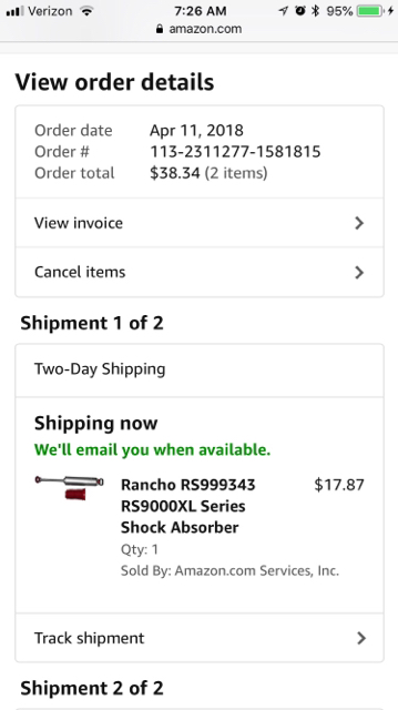

Found some Rancho 9000s on amazon prime for 18$ each . They were for a later model Nissan Patrol like late 90s to mid 2000s, which are a heavier than a stock XJ, which is perfect since my rig is way heavier than a stock rig . Little shorter than what I have now, super cheap for a decent namerancho 9000 shock.
They already went up in price back to like 100$ each. Amazon is crazy. I think tbey might be out of stock since it says that when I check my order that ship date is pending which ive never seen before.
Go to amazon type in rs9000xl. I search for under 50$ per shock and i search every part number.
Yeah they are telling me now that one is shipping today and they cant find the other so now It looks like ill have one shock coming for sure. Yeah these shocks are normally 113$ each, so 17$ is almost 100$ off per shock so I am keeping on their asses to get me both. The compressed/exteneded length of 15.6/24.5 should be perfect for my ride height of 19.5" roughly 4" up and 5" down. They are for a heavier Nissan patrol . Im not a fan of the adjustment knobs but I am curious to see if they do anything.

they shipped out one of the shocks so far...Curious to see if they cancel the other shock or if it takes like a month to ship it...
My old ones where something like 17/27 or something like that
Looks like they honored the price and both shocks will be here this week. Crazy.

Amazon is giving me a 20% credit off the order for shipping the second shock late... haha. totally awesome. pays for the bushings .
