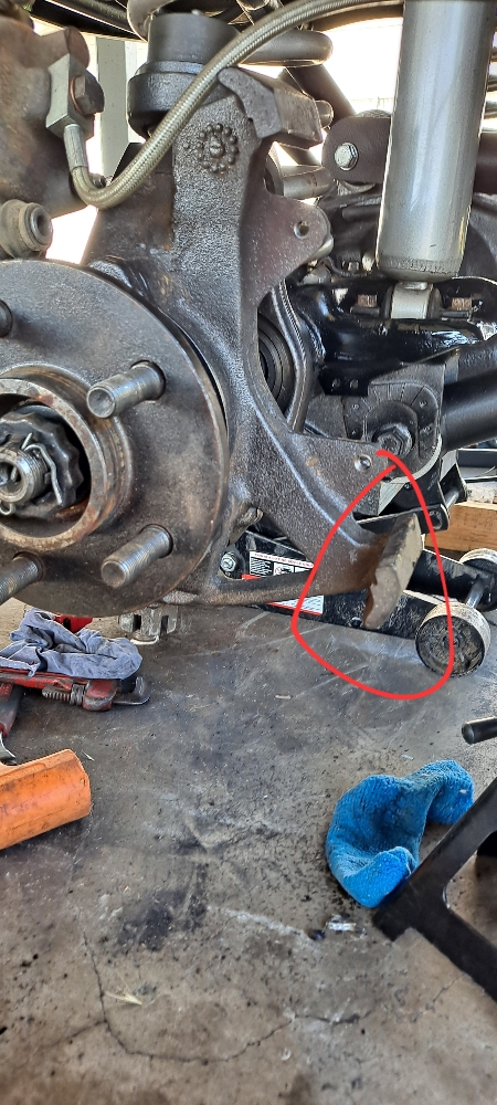

Your gonna need to remove your brake pads unbolt your caliper and get to where the knuckle is free

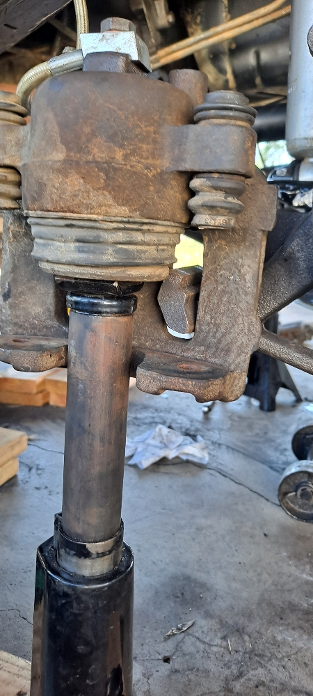

Then place your caliper with the piston facing down and put your jack underneath the piston on the knuckle

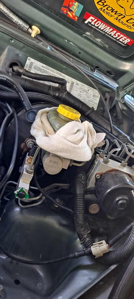

Now you have a makeshift vice, before you start jacking the piston up loosen the cap to your brake booster and wrap some rags around it so fluid doesnt go everywhere like it did on mine.
Thats it simple but effective if you have nothing else

Yeah these were pretty frozen i tried a screwdriver and a prybar, the fact that the pads were just about metal on metal might have had something to do with it. Compressing the brakes eas something i overlooked while swapping this rubicon axle in and used what i had
