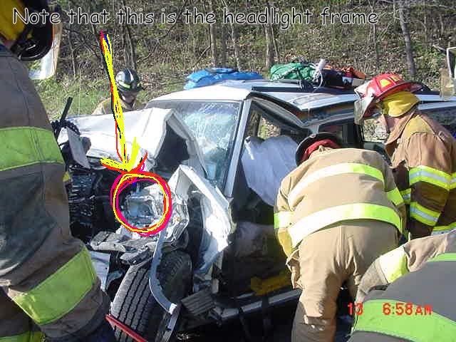

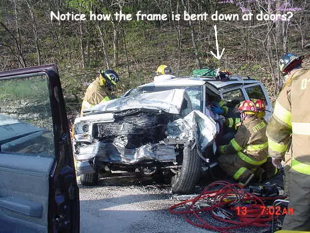

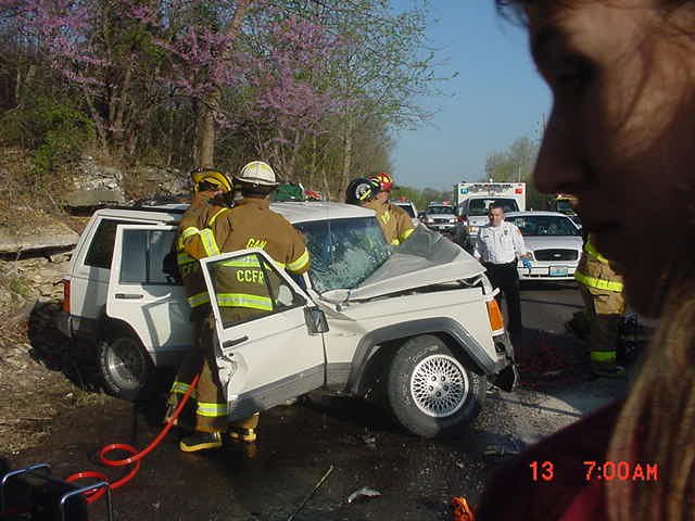

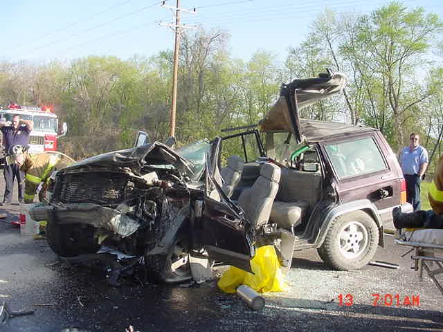

Sorry, no pics of a HI-LIFT on the hood. Here's why I wouldn't want it on the hod. This is a rather extreme case of a front-end impact which would send you to the hospital regardless. Still, why add an extra projectile into the mix. The sheetmetal on a hood is very thin. You don't know where that jack is going after a collision or a roll. There are so many other suitable locations to put a HI-LIFT. I don't know why people put them on their hood.
