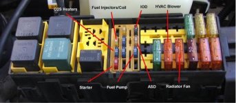

I ran my 98 with no cat or downstream sensor with no problems other than a light for months. The downstream shares ground and heater circuit with the upstream so be sure the harness is not shorted and the heater circuit fuse is good, it’s in the PDC, fuse 15amp, should be number 23.
You can also just plug the sensor back in and tuck it up, should make it happy thinking it’s doing its job. They just don’t usually last long exposed.
