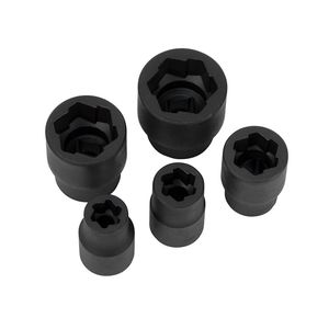

I have one of these bolt extractor kits. Haven't ever used with a lug nut. In decades of owning a vehicle I've never had a lug not that couldn't be removed with a lug nut or star wrench, but I guess it could happen, something hits the lug and it becomes damaged, etc.
There is another type, second pic, that uses reversed threads, used for keylock lug nuts, can also be used to removed regular lug nuts.
An impact wrench helps to remove a nut with which ever socket type tool your using.
Irwin Bolt Extractor

Too late. Previous poster already got it (bolt extraction socket).
I guess I was repeating and clarifying myself as in an earlier post I'd mentioned "nut cracker or a nut remover" A "nut remover" is also referred to as a "bolt extractor" and visa versa.
Anyway a nut cracker or nut remover will work if there's enough nut exposed to grip. A nut cracker sometimes works better than a "nut remover" aka "bolt extractor" as it potentially cracks and removes the nut with less hassle.
