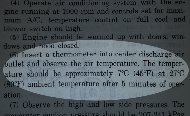

Done half a dozen of them in Arizona. No issues. My AC blows 39.5* out the vents.......
39.5, is that degrees?
Wow, what do I have to do to make my a/c run that cold?
Sheez.
