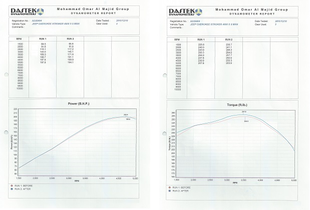

202rwhp/258rwtq ?dyno, 'Cheromaniac's' 4.6L 'poor man's stroker"
'92 XJ Laredo 4-door 4WD with AX15 5-speed manual tranny, NP231, D30 front, D35 rear, 225/70R15 tires
4563cc "poor man's" stroker (+20 thou overbore, 258 crank, 258 rods, 677P pistons, 9.25:1 CR, ported 7120 head, stock cam)
Homebrew CAI, Modified Ford 65mm throttle body, 65-to-62mm tapered TB spacer, '01 XJ intake manifold (injector bosses ported), Thermotec manifold heatshield, IAT sensor relocated to CAI.
Borla header (modified with 3" collector), custom 3"-to-2.5" downpipe, no cat, Flowmaster center muffler, Magnaflow rear muffler, Kolak 2.5" tailpipe with Pacesetter Monza 3" chrome tip.
Clutch fan delete (dual electric fans), Ford 24lb injectors at stock 40psi fuel pressure, homebrew MAP adjuster set at 5.3v, stock ECU.
Dastek load bearing dyno:

My 4.6 stroker produces 89% of maximum torque at only 1500rpm and that isn't a myth. It'll also pull cleanly on a level road from 20mph (600rpm) in 5th gear and easily do a standing start from 3rd gear.
Love the flat TQ curve of Dr.Dyno's stroker, 230+TQ from 1500-4500 rpm.
Dr. Dyno's stroker build is pretty close to average max stroker build less cam(he uses stock cam).
5speed, 4563cc, ported head and manifold, 9.25CR, 65mmTB, headers and downpipe, cat back, CAI, heatshield, no cat, stock cam-
Doesn't get much better that this. Nice engine build.
