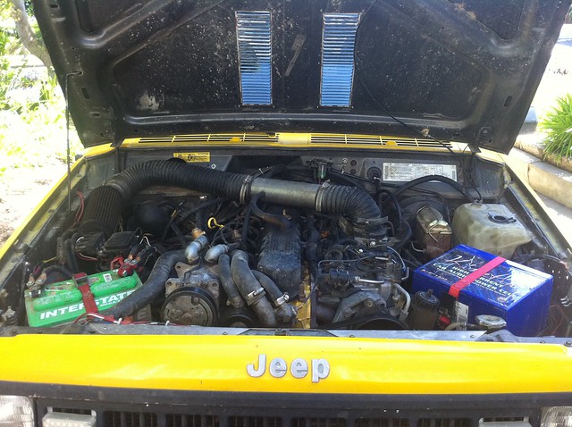

I have mine where the stock air box was, my friend also has his like that. No issues with taco or metal tearing.
I have mine on an isolator with all accessories on the aux battery, great for leaving the HAM on overnight or playing the radio.
What tray are you using on the driver side, or did you make one (that you should also sell)?
The only tray I found was from Wrangler Northwest. Definitely not the best product as requires some improvisation, minor grinding and instructions are inadequate.
Note that the TCU needs to be bolted to the back of that mount.
Other than that, it works ok. I have my installation documented in my CF build thread...

I should make a version for sale, it bolts to the factory air box bolts plus one addition point on the inner fender.
