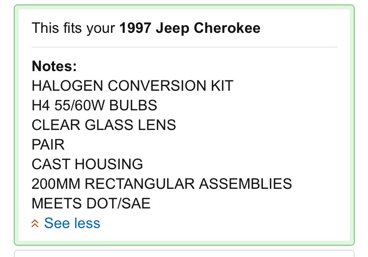

Any thing about the rampage housing?
So going off of the description these are dot 'approved' I'm curious if anyone's used these?
they look like they would blind the crap out of oncoming drivers.
That's why I'm wondering if anyone's used them, if they have a good cut off line and such lol
