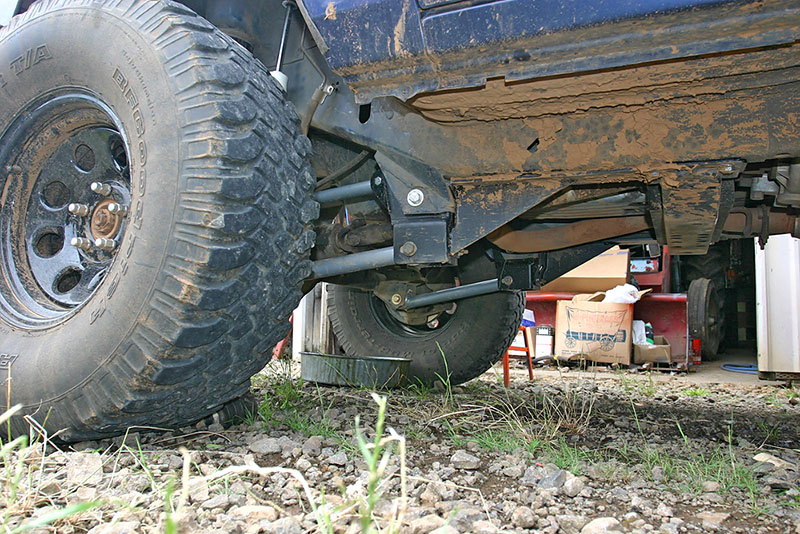

Since its already bumped. Just to clarify, the brackets from Off Road Toy Store did come with the braces and everything for $250. I've had it all installed for a couple weeks now.
Twisted
Looks like you have the drop brackets installed on the RE4.5" kit. It also looks like your lower control arms are fixed. Have you had any issues with the arms now being too long? Is your axle placement correct and your caster?
I would like to add the drop braces to my 4.5" kit as well. Any info would be helpful. Thanks, Paul
