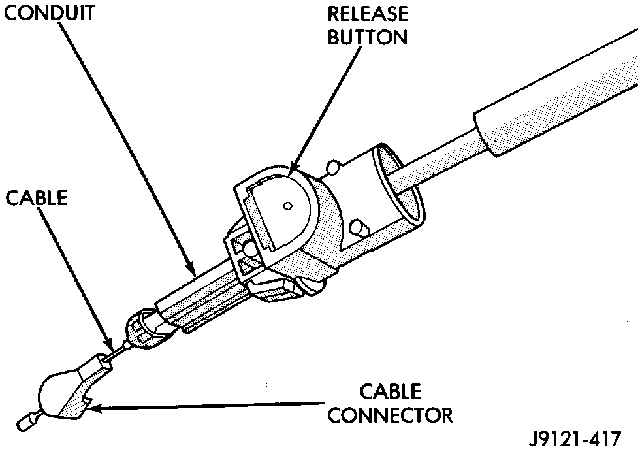

Anyone that hasn't adjusted their Throttle Valve cable do it. WOW.
in the original directions, there should be a number 3.5 and a number 5--
3.5) do not release button
5.) now release button
If you release the button, it will have to fight the built-in lock to pull the cable
Shorty says to hold the button until AFTER you cycle WOT.
If you continue to hold it as you rotate the throttle the conduit will come out. Release the button after you push the conduit in then rotate like the original post.
Krawler says to release before BEFORE you cycle WOT.

I am having very abrupt shifting and TC lock/unlock issues which is why I'm trying this. When I went out to do this, the sheath was pushed all the way in.
Thoughts?

I'm not sure how people are adjusting their throttle cable then - because you can see mine doesn't adjust - it's either 0% out or 100% out.
I'll manually adjust it and see if I can get it smoothed out some. Thanks.

Sounds to me like the plastic sheath is just gummed up with road dirt or something. If you have having trouble adjusting it, hose it down with wd-40 or similar and run it in and out a few times by hand, see if that makes it operate more smoothly, then readjust it.
How far out should the Conduit stick out when properly adjusted

Mine was sticking and would either:
1) pull all the way out when it did let go
2) not come out far enough because it was sticking/binding and I didnt want to break anything.
What I did was adjusted it all the way out and then bit by bit back in (away from TB) until I could just open to WOT and that was right around 50%. If you go too far back in, you won't be able to open all the way to WOT. It took a little bit of trial and error, but you should be able to find that sweet spot.
reviving this from the dead, read somewhere that to properly do it(haynes?) that you are suppose to push the button in hold, while holding it down push in the conduit, then while still holding the button down, have some one push on the gas pedal all the way down as far as it can go, while holding the gas pedal down, release button. so hopefully that clears all that up and any confusion.
now the issue I'm having is that when I do mine, I dont hear ratcheting at all, is just slides out so I have a feeling that its stripped maybe? any thoughts on that? if so, this can be replaced right?
try moving the "conduit" in gently once it's adjusted-- if it seems to stay in place, it's not stripped. They don't always "ratchet" into place.
