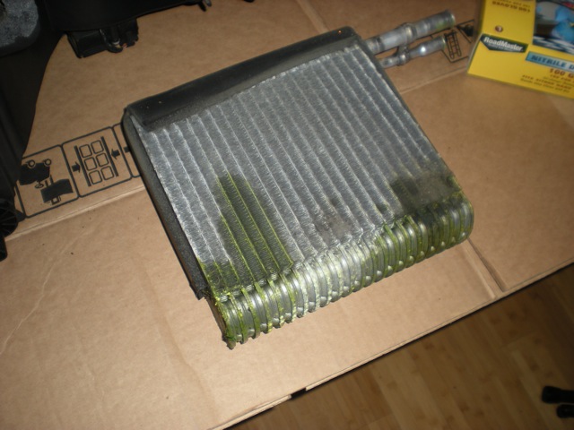

Gotcha. I take it you bought OEM evaporator cores? The dealership told me that theirs come with the foam pre-installed, whereas most aftermarket ones do not (like mine - it is completely bare).
Well, I finally cracked that bad boy open... I don't see what the big deal was.
:wierd:
For sale I have one mint-condition evaporator core:
This is gonna be some fun clean-up.
One thing I noticed is that the face of the evaporator has a pre-filter of sorts (a thin sheet of open-cell foam that is held in place by some plastic pieces). The dealer said there's no reason to re-use it, as it'll eventually disintegrate and blow out through the vents... I somehow think this may be a bit short-sighted, as it must be there for a reason.
Is it meant to trap dust before it reaches the fins of the evap, or is it meant to be a condensation magnet/collector of sorts to encourage condensation to drip down and away from the evaporator? Did you ever re-use this foam?
Nope, the evaps we put in were aftermarket from Advance, as I was selling them at the time :D
The dealer is absolutely correct about the foam. In fact, i'm surprised it hasn't blown out already. All the ones I see go bad, the first sign is the foam starts shooting out at you when you turn the blower on. The two i've replaced both did that. Mine did it as well, followed shortly by no AC all of a sudden one day, but i'm still in the "recharge it before I go on a trip" phase lol.
I'm not entirely sure what it's there for to be quite honest. I always thought some sort of "blanket" for it. Can't see it trapping dust or anything. That's what cabin air filters are for (which we don't have anyways).
Sweet deal, thanks for the info man - I bought mine through RockAuto, so I went super-cheap with it... Probably why it doesn't have the foam.

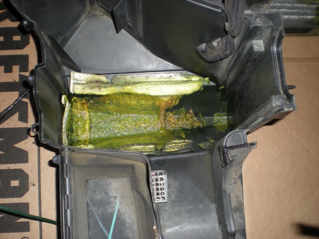

Also, I found this stray part upon going to put the new heater core in:
I can't for the life of me figure out where the hell it came from, or where it goes - it was loose in the lower half of the clamshell right beside the old heater core (I very well may have dislodged it during disassembly). Any ideas?
Interesting you have an aluminum heater core. The ones i've put in from the local parts houses were copper...
As for that piece, I think maybe it goes across the top of both the heater core and evaporator? Kinda like a brace. Been a year or since I last had one of these open, so i'm having a hard time recalling if there was a brace on top or not. Another possibility is maybe that piece sits on the bottom, then either the core or evap sit on top of that...but I don't recall there being anything there.
Yeah, I'm perplexed. I've seen a bunch of photos of these HVAC boxes and not once have I seen this part. I can safely say it was not beneath the evaporator (as it was bone dry and clean when I found it), but can't seem to find a logical orientation for it elsewhere...
One peculiar thing about it is the wire/vacuum line clip on top of the piece (top left corner as oriented in the pic above). This leads me to believe it's an external piece, which may have fallen in through the defrost/windshield vent on top of the box while the unit was being removed (as it was somewhat dragged out from under the dash).
Think this is a logical assumption to make?
Going on that theory, is the defrost door still attached? It would be the one that sits behind where the radio would be and controls whether air goes to the defroster or the front vents.
Yep, sure is. All doors are in place - nothing appears to be missing at all.
