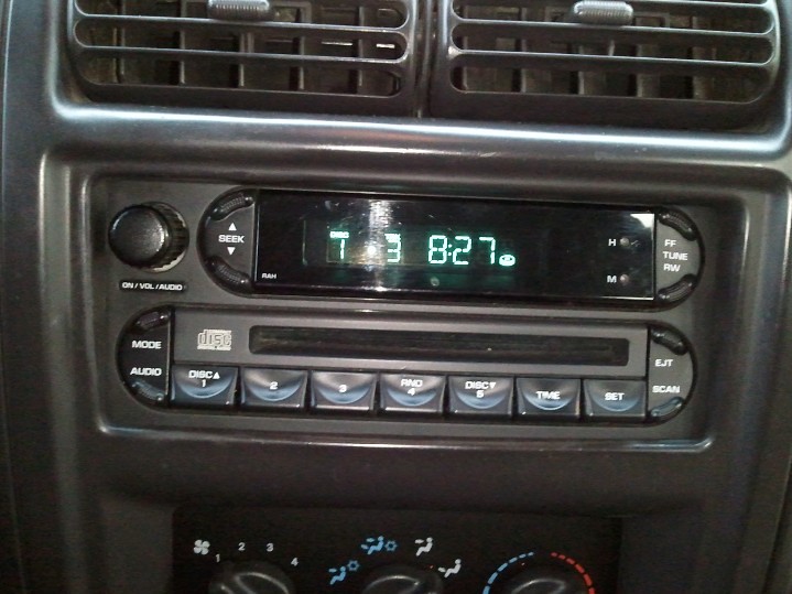

In my setup, the round sides RBK are behind the edges of the bezel. A trimmed Dodge Ram bezel was used to fill in the gaps at each corner. You can make it out in the pic.
Update. This weekend I installed an 'RAH' oem head unit from a 2008 Chrysler Pacifica. It has plays Mp3's, and also has RDS. I'm using the factory changer port with my ipod interface. I picked up the stereo for $25.
The good thing about the RAH versus previous chrysler models is that the radio face is square. The face still has a slight curve to it, but overall it works well with the square XJ console.
