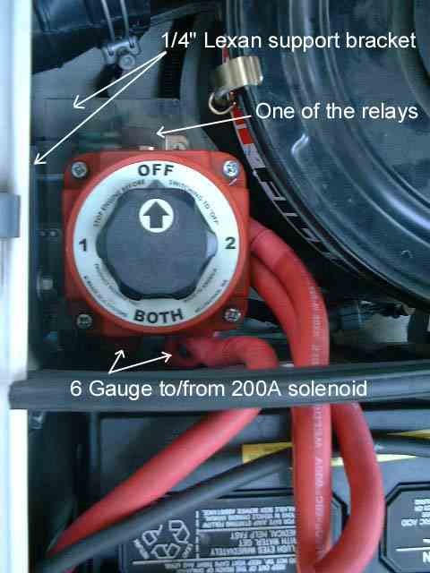

One thing to be careful of.
I set up a dual battery system using a 200 amp continuous duty solenoid set up with a 3 pos switch.
-Normal position was connected only when ignition on for charging.
-Pos 2 was disconnected all time.
-Pos 3 was connected all time (for jump starting)
I was using an Optima Red Top for standard and a Yellow Top for aux (winch, lights, compressor, inverter, etc)
After early replacement of the Red Top I found out that Optima (and everyone else, it turns out) strongly recommends NOT using two different types of batteries in a parallel system unless an isolator or "smart solenoid" system is used.
Apparently if there is any difference in the two batteries, charging them together is a problem.

Here's a great link about this subject.
BillaVista's Dual Battery setup
