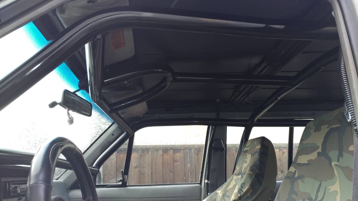

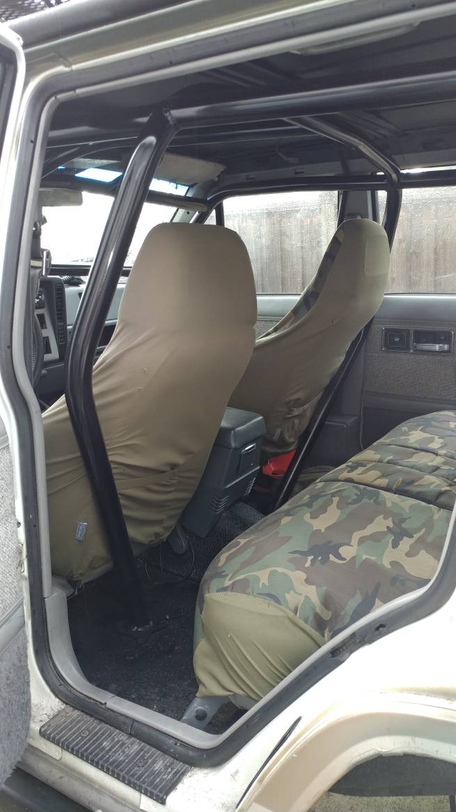

So anyhow, I had to stay home with my kid yesterday because she was sick, so I took the opportunity to get acquainted with my model 32 bender I bought like 5 months ago.
I started on my cage and got my B pillar bent up and feet welded on. I'm happy with it, but it could have been another 2" wider at it's widest point. It's going to take a little more time to get familiar with it.
I'm going to copy some parts of the D&C kit. Hopefully Friday I can get some more work done on it.
Sent from my SM-N920P using Tapatalk
XJ's sure get small inside once you put a cage in. I could have got it tighter to the roof, but I don't think I would have been able to weld the top of the joints.
If I were to do it again, I would do an EXO.
I got some roll bar padding from Summit and sewed up some covers out of olive drab Cordura. They fasten with velcro. Im just putting them where you're likely to hit 'em. I think they came out today. Ill take pics tomorrow once I get them on.

So I had to pull the passenger side interior trim panel so I could weld the rest of the tube to the D pillar mounting plate. The only problem was that with the cage in place, that triangular indentation that goes into the quarter panel wouldn't clear the unibody...so I had to cut out the triangle which left a huge hole in the trim panel. I cut it out and then just patched it with an aluminum road sign that I riveted on. I think it looks OK.

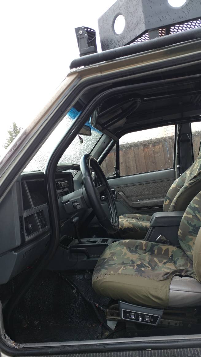

What brand are those seat covers? They look like they fit decent on the stock seats. I haven't been able to find any good fitting covers that are decent priced.
Cool build so far.
They were some cheapies off of Amazon. I couldnt paste the link, but here's the description. They're $43 right now and they do fit pretty well. Im contemplating making some out of OD green cordura because I have like 9 yards left after the roll bar covers.
FH Group Universal Fit Full Set Car Seat Cover, (Hunting Camouflage) (Airbag compatible and Split Bench, Fit Most Car, Truck, Suv, or Van, FH-FB111115)
