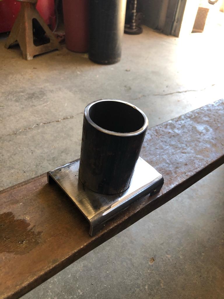

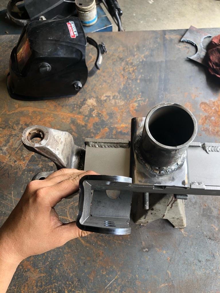

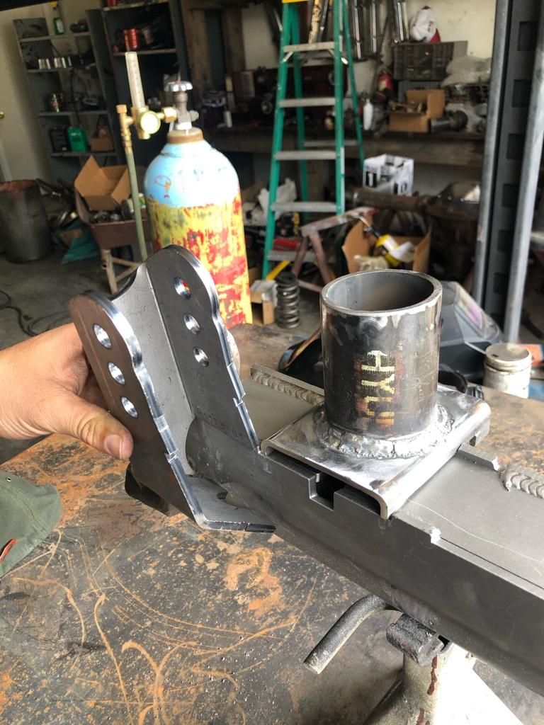

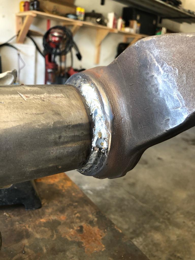

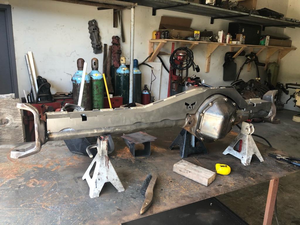

Anyway, got to work on my axles for the first time in a while. Got some metal to start fabricating some spring mounts. Then decided I could try to weld the Cs on. Got the angles set and started burning it in and it turned out better than expected. Tacked the truss on then realized that I needed to paint under it. I’ll fix that next time I work on it.
You’re right, those Cs do look good. What angle are you planning on welding the truss relative to the Cs (caster)?
Thank you! The C’s will have 6-7 degrees of castor with ~12 degrees of pinion angle. From there the truss will be 2-3 degrees (forward) from level at that point, I already trimmed it quite a bit and I didn’t want to do that much more trimming.

I got ya. I think I’ll see if I can fab something to tie the C’s into the truss on top because it’s pretty close already, then get some channel iron or tubing for the bottom. Wife caught me checking out those Ballistic Fab C gussets and was giving me a hard time haha!
One thing I’m thinking of is clearance between that track bar bracket and your drag link at full lock. Are you reusing stock knuckles? Maybe loosely mock the passenger side knuckle up and see if there will be obvious interference issues at full lock.
