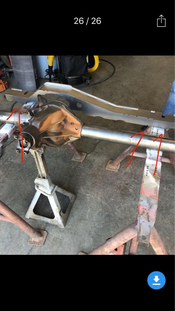

The truss has little notches plasma cut out for the LCA brackets. I almost didn’t see them when I welded the truss to the axle tubes. TNT makes a high clearance LCA bracket that I think uses the same notches to locate the LCA. Want a measurement for reference?

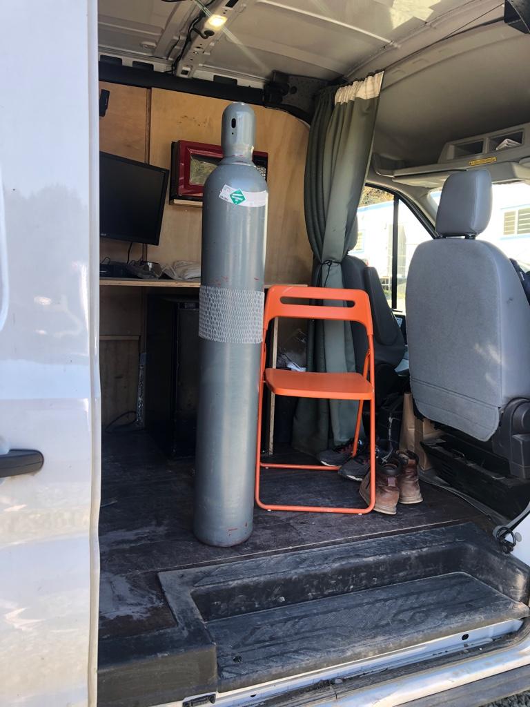

Since I’m looking for a gas bottle myself and I think this adds value....
I called a few places about bottles and the price to buy a 150 vs a smaller bottle wasn’t very much. The amount of time you have to weld is what mattered. If you’re running the gas at 25 CFH a 150 tank would theoretically get you 6 hours of welding. An 80 would get you a little over 3. The cost to refill them is really what makes ME want the larger tank.
When I legged my own beer I used a 5 pound CO2 tank. It stored nicely, but after about three or four kegs it was toast so I upgraded to a 20 pound tank. The cost to swap a 20 pound was like $35. To refill a 5 pound was like $15.

Wow, that’s a pretty big difference in price to refill. I think I’ll go with a 125 or 150 cfm depending on what the place has.
