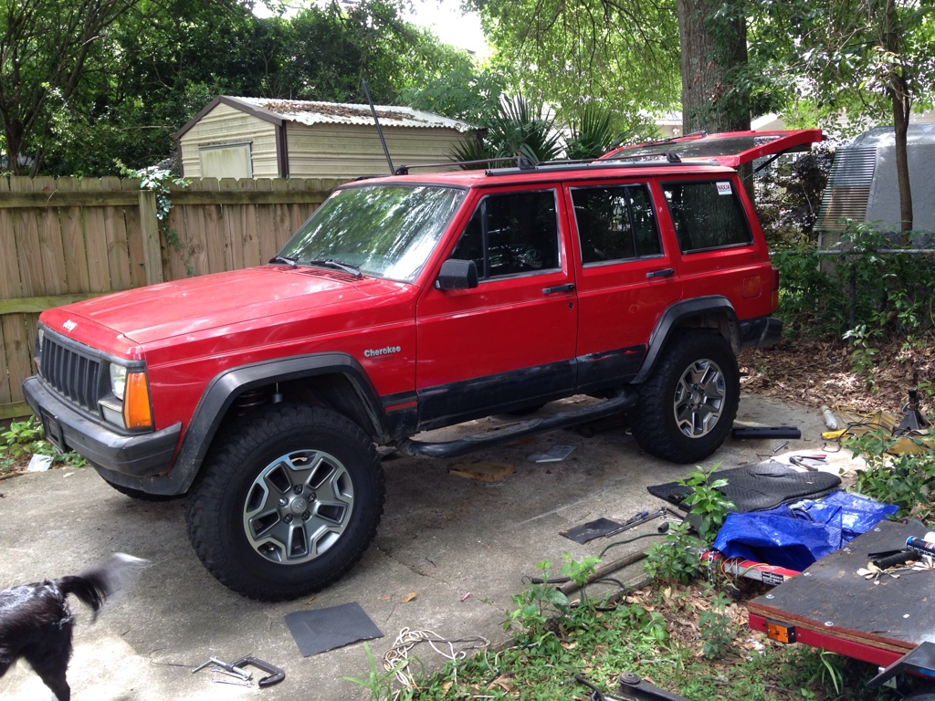

nice lookin' jeep! Those do look good, but I feel like i'd prefer a wider stance. Is that silly? if not, spacers, or or less backspacing?
Thanks!
some TJ Moab wheels will do that. They're 16x8.
Be aware that if you go any wider than that the tire will eat your fender when you flex it.
Same jeep and tires but with Moab wheels
IMG_20150406_185238_705 by nsjames805, on Flickr
as compared to the other one in the driveway on stock KJ steel 16x7s and bridgestone 245/75
IMG_20150406_185258_086 by nsjames805, on Flickr
