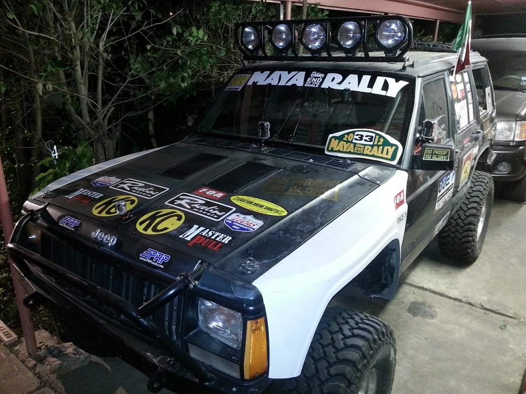

TEAM BONGO MEXICO - KOH EMC #9009 ready!
We sent in our entry before the deadline, after getting back from the end of the world Maya Rally this past friday night, this was good because we had to chance to test our junk down in central Mexico.
Everything worked great, rig is now stored and prepped for KOH EMC event, which is now on our 2013 Race Schedule
We are also racing in the KOH in this junk
See you on the lakebed! The competition looks fierce, this is going to be a bad ass Bongo! Who else is competing in a Jeep Speed in the KOH EMC?

Looking forward to seeing you guys out there and racing each other. I think this race is going to be a good time, with plenty of good competition. How are you on the rules? Looks like you might have an issue or two.

Make sure that you leave time to add a winch, a rear hatch, replace the bobbed rear quarters, install new shocks that don't come through the floor, and replace the floor where the shocks came through. :)

no problem, thanx for the input. I have teched KOH several times and know what the scruteening staff wants, on the other hand this will be our first KOH EMC and understand we have to make some adjustments. We will be ok, we hate to use winches, but yes I will bolt one on there when I get back. I also have to mount the new KC HiLites 9441's, Raceline Beadlocks and new tires, really wish I could change the Dana 30 front diff. :wierd:

I think the bigger concern is that 4600 class does not allow cutting of the fenders behind the rear tires, does not permit shocks through the floor and requires that you have a hatch that opens and closes.
It shouldnt be too hard to make some new shock moutns under the body and plate over the existing shock holes in the floor, you can make a tube hatch similar to ours I think, but the fenders would require some work. Maybe rear armour that covers up whats cut in a stock fashion.
I sent an email to KOH tech. But right now our set up is working bad ass, plus I would like to export the rig to Skandinavia in April to use for some FIA European endurance offroad races and some other cool offroad rallies that I have discovered over here, so I dont really want to make any big changes to the design that we have right now.
So if they dont allow us to race, that's ok we can cheer you guys on and just race the KOH in our other Ultra 4 spec junk.

This is what KOH tech emailed us when we enquired about our junk:
Response from KOH TECH: From what I can see of those pictures your jeep seems to be plenty safe to race and would pass the safety portion of the tech inspection.
If you plan on running the stock class (4600) an operable rear hatch would be required. This is because the rear hatch is being considered just like the doors. it can be tube, sheet metal, etc and is not required to be a full hatch...but there must be something there that resembles the OEM hatch and operates in the same manor as from the factory.
From the link of pictures your jeep speed it looks like it most closely meets the stock rules (4600) but I can already foresee some issues with being 100% compliant for the class rules. Most notably there are some body requirement issues with the rear bumper. It appears you cut the rear 1/4 panel a bit to fit the bumper and for tire clearance. While some of this is allowed, from what I can see of the pictures it looks like too much was removed and it wouldn't meet the rules.
honestly though because I don't have the rig here in front of me the only way to decide would be for you to read through the rules and figure out which one you fit best in.

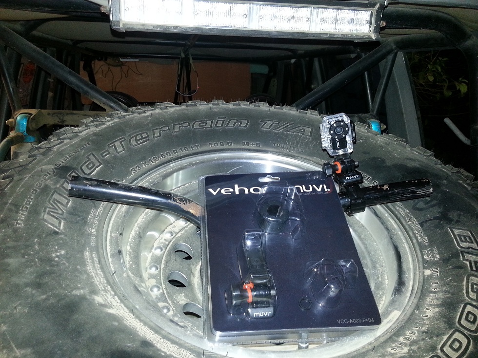

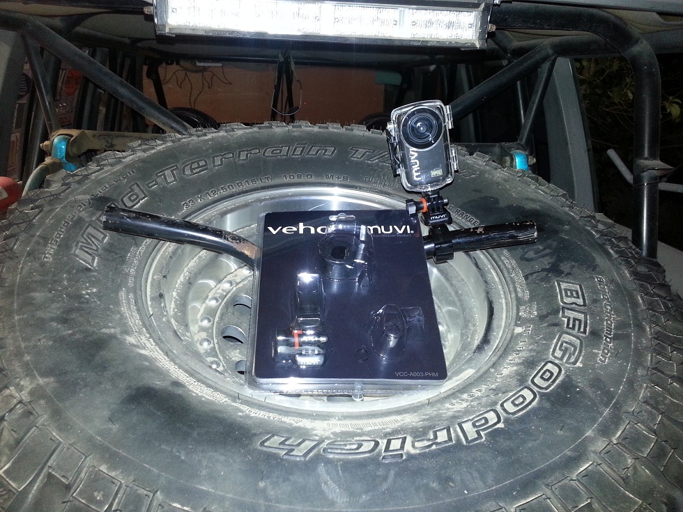

As a underdog racer we would like to help out and we have been talking to VEHO MUVI over here in Europe so if anyone is interested we can get you a racer rate. PM me.
