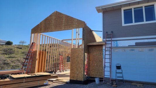

He convinced me to build the gable ends on the ground rather than in place because he knew a builder that had a boom truck that was willing to help out. He came by to check it out and determined that this was beyond the capacity of his equipment. So Paul called another friend of ours, builder who also owns the local brewery https://www.smeltertownbrewery.com/ .
He had just finished using his telehandler, said come get it right now at the Cottonwood airport.

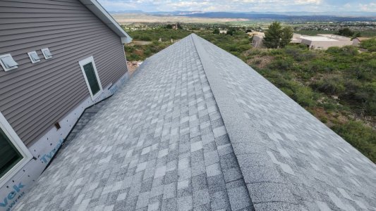

The roofer that did the house was too busy to take any more jobs for the foreseeable future so I got a guy that Paul recommended. He got it done pretty quickly despite getting rained out a couple days
