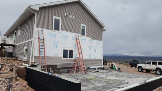

After stripping the forms, next step was to get ready for the slab. When I built the house, lower level was just intended for storage and my woodworking shop.
So I didn't do a bathroom, just a utility sink. Then I finished a 16x20' room at the bottom of the stairs, and was starting to think that a bathroom would be nice. So that got added to the garage.
To this point I had done everything myself, with a little help from the wife and my neighbor James when pouring the footings, and a half day from my contractor buddy Aaron's helper when pouring the foundation walls.
I knew I would need more help with the slab so I got Aaron and his helper, and another good friend who had some concrete experience.
After weeks of delays due to rain, snow, and freezing temperatures, we were finally able to pour.
In order to not lose the only window in the master bath and the matching small one in the bedroom, I had to do a 4' wide saddle to connect to the house.

Like everything I build, the slab is overkill. 6" minimum thickness and up to 8" where needed. Aaron probably knows more about concrete than three of your typical concrete guys.
