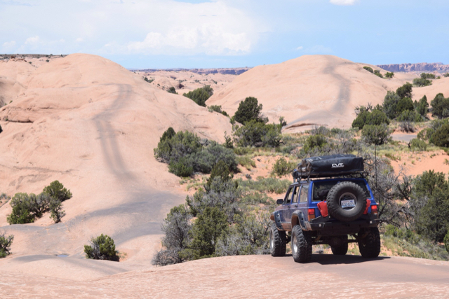

I have been using a simple two bar gutter mounted Yakima system for a little over two years. I have never had a issue with this set up and I use a CVT Shasta tent and am extremely happy with it as a product and the company is very easy to work with.
My wife and I both sleep in the tent and during a three week long Moab trip where we drive from eastern Wa to Moab all over Utah and home we never once experienced a problem.
Let me know if you have any other questions.
Thank you. It is a Yakima basket that I took apart and used the front piece and the divider then mounted it using the factory rails. The only problem doing this is the front window spring rod cannot be used because the hole is blocked.
