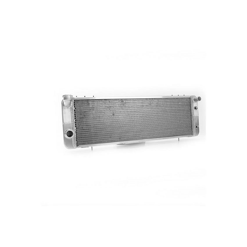

If it was my new Griffin radiator, you'd could hear me screaming in Maine!!
