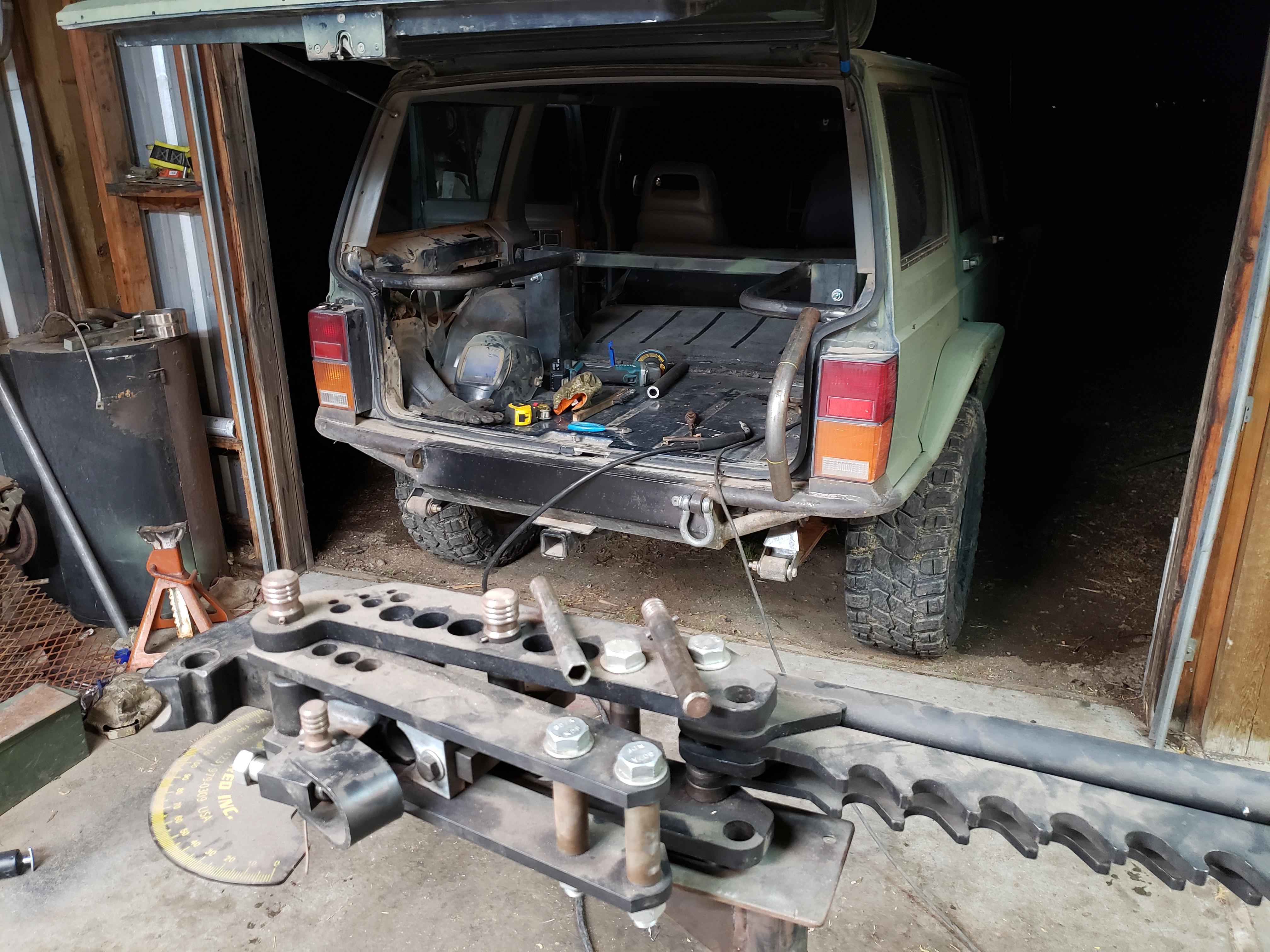

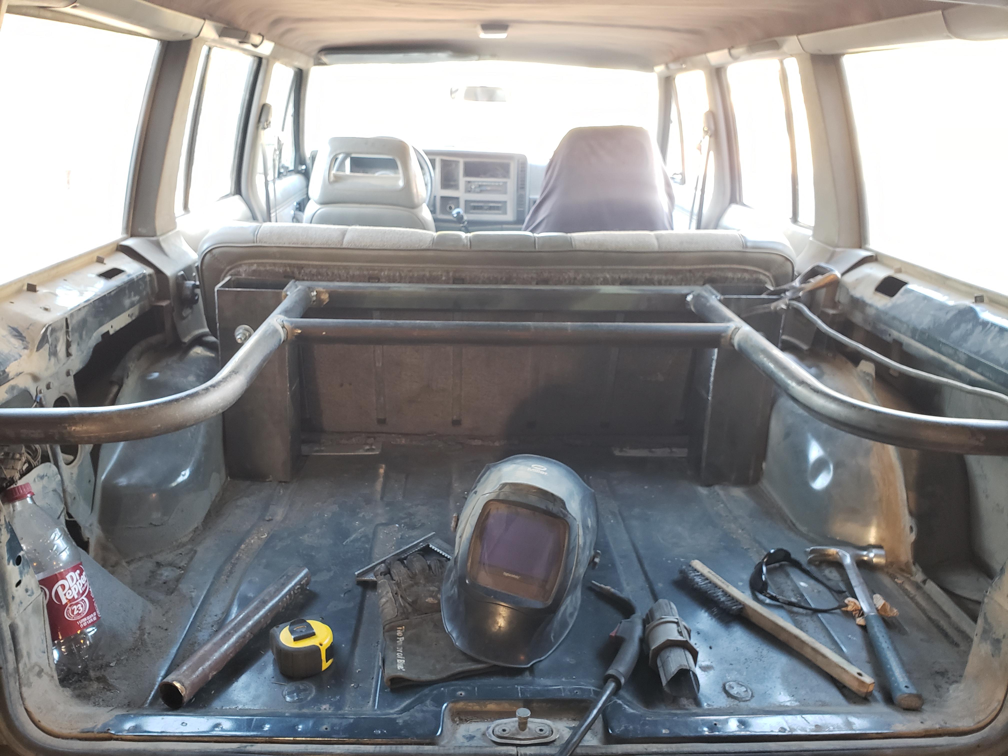

Didn't hack on the 30 tonight.
Was thinking to make use of shock towers for extra storage over fenders then started seeing things inside and out.
Theres enough tube around my place things could get scary. Aswell as expanded metal
Man o man I need a friend with a bender.... How far are you from Fort Collins CO??? LOL

The bender has already paid for itself with the bumpers and fenders.. now you’re just having fun which I envy! If I had one and the tube, I’d bend up a cage to sho. Half exo with halo roof rack and internal spreaders and abc pillars. Would be easy to tie in to your fenders and even the rear stuff you got goin on.

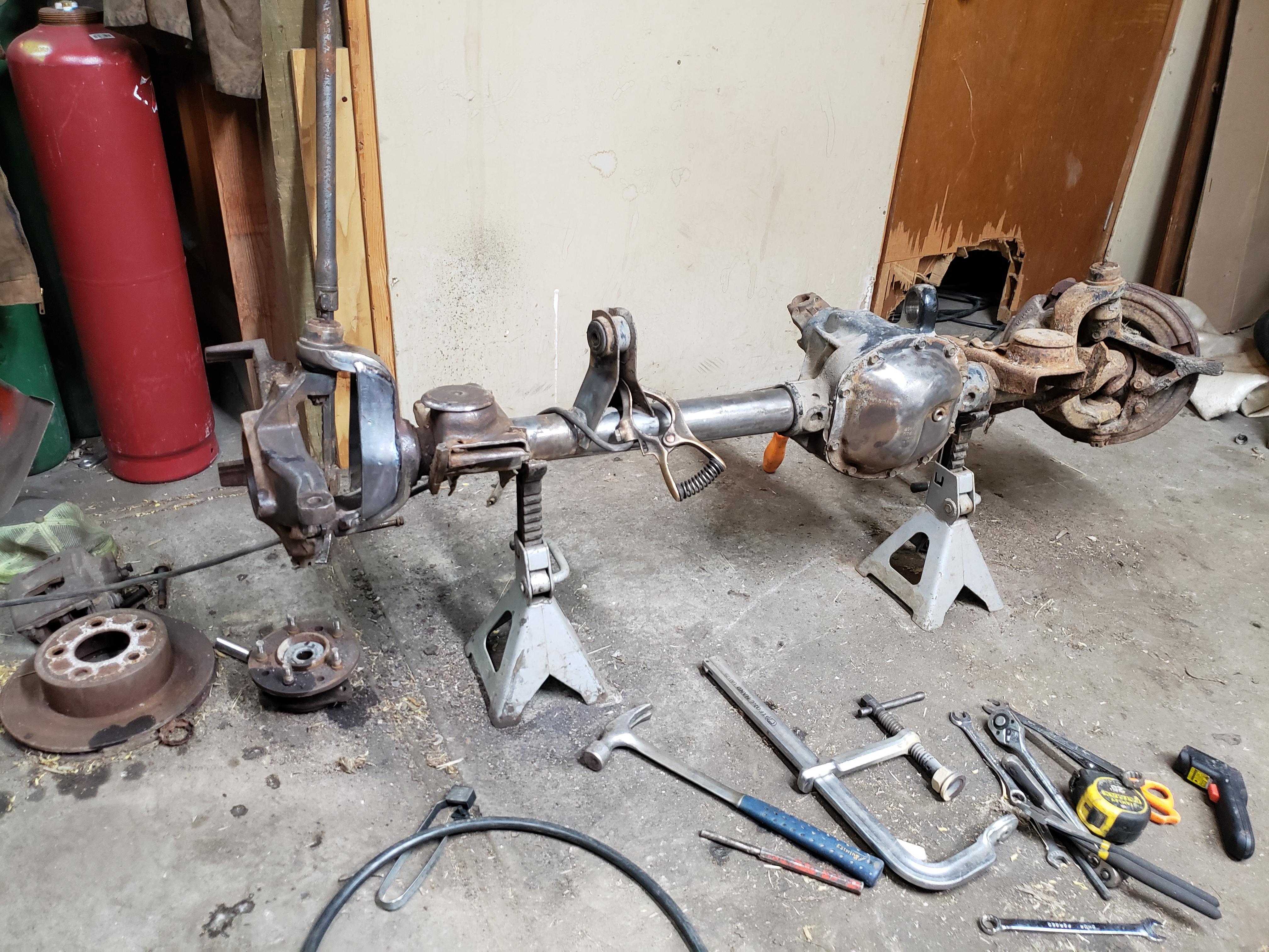

These might keep me from tearing to much into the dana30 axle swap may be coming soon..

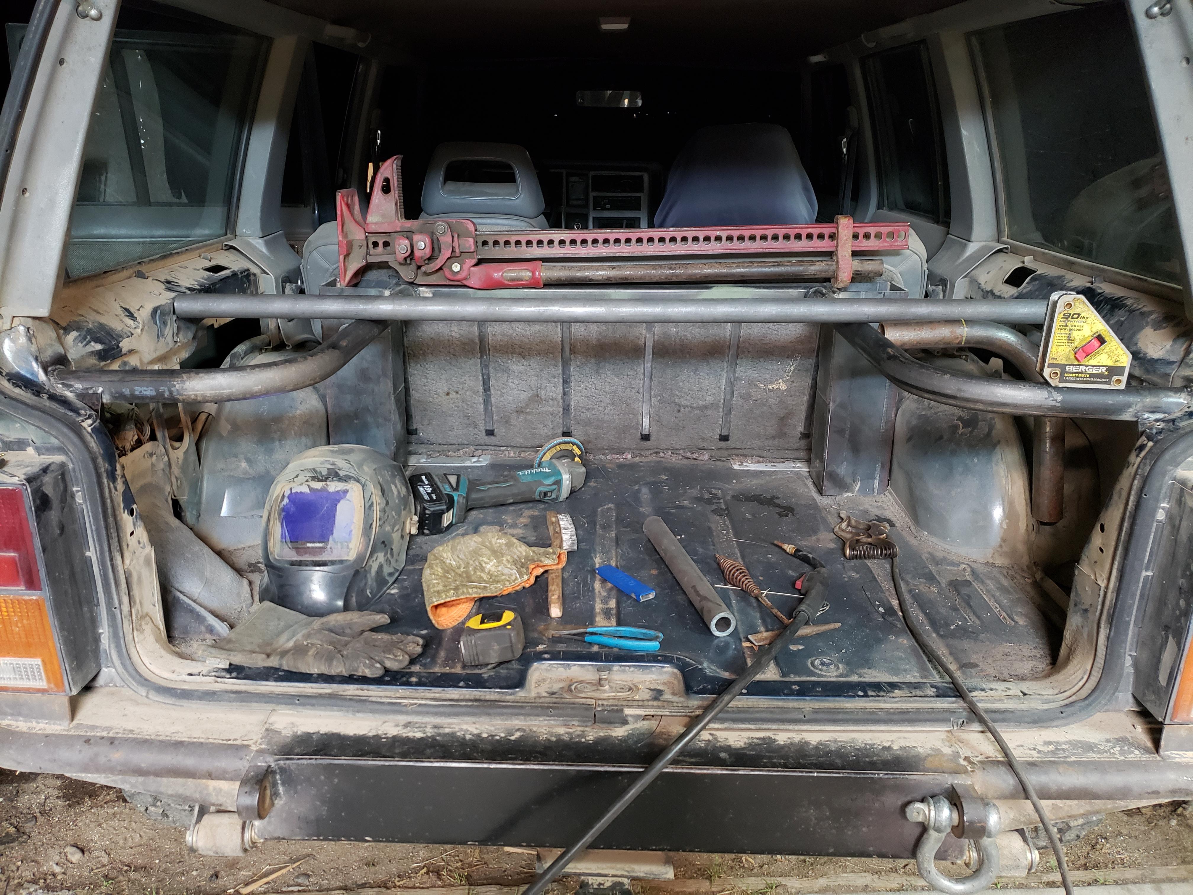

I did some looking and wanted to fit a decent sized cooler in the back without loosening to much storage. Tubes creat a second deck for storage rtic 45 cooler fits between the tubes and is 15 7/8 tall the tubes are 16" from cargo floor and will be sheeted with expanded metal
Hoping this will provide tons of accessible storage under and over. May run a tube around the ceiling line to creat a wall behind the seat to mount jack shovel and fire extinguisher.
I feel naked not having a full size pony shovel in the jeep. This wall will make that possible. The long tools just dont fit on the floor.

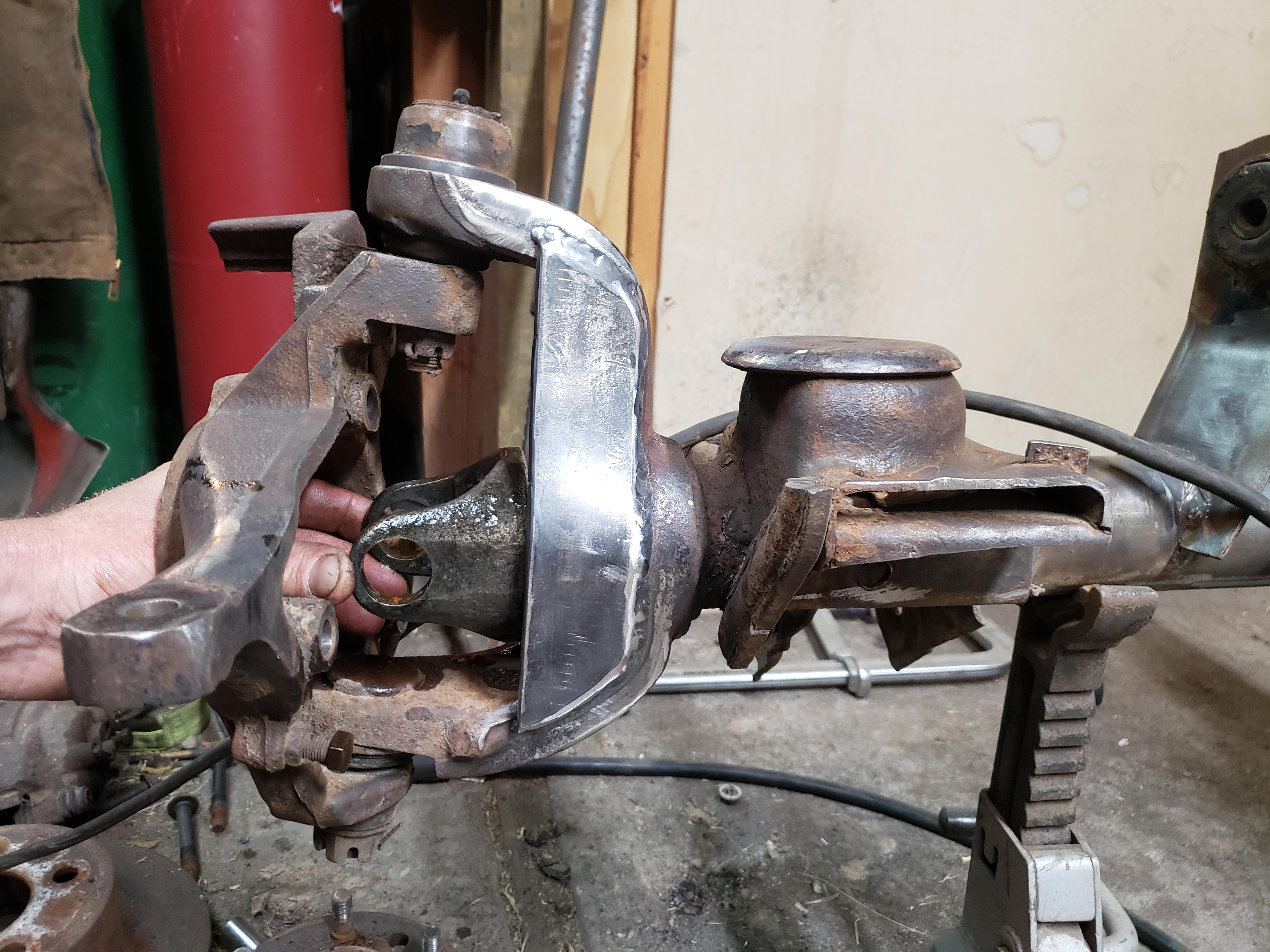

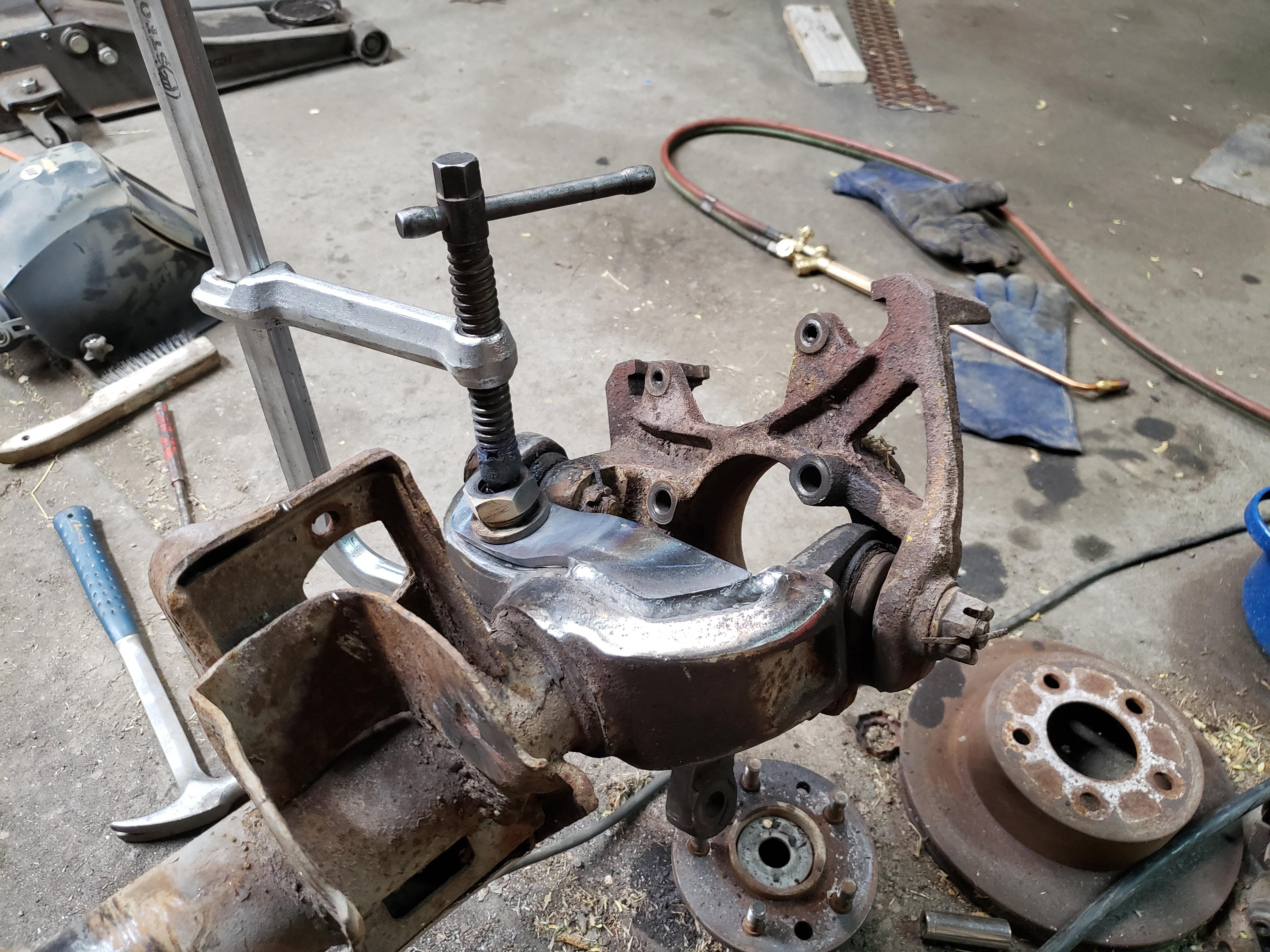

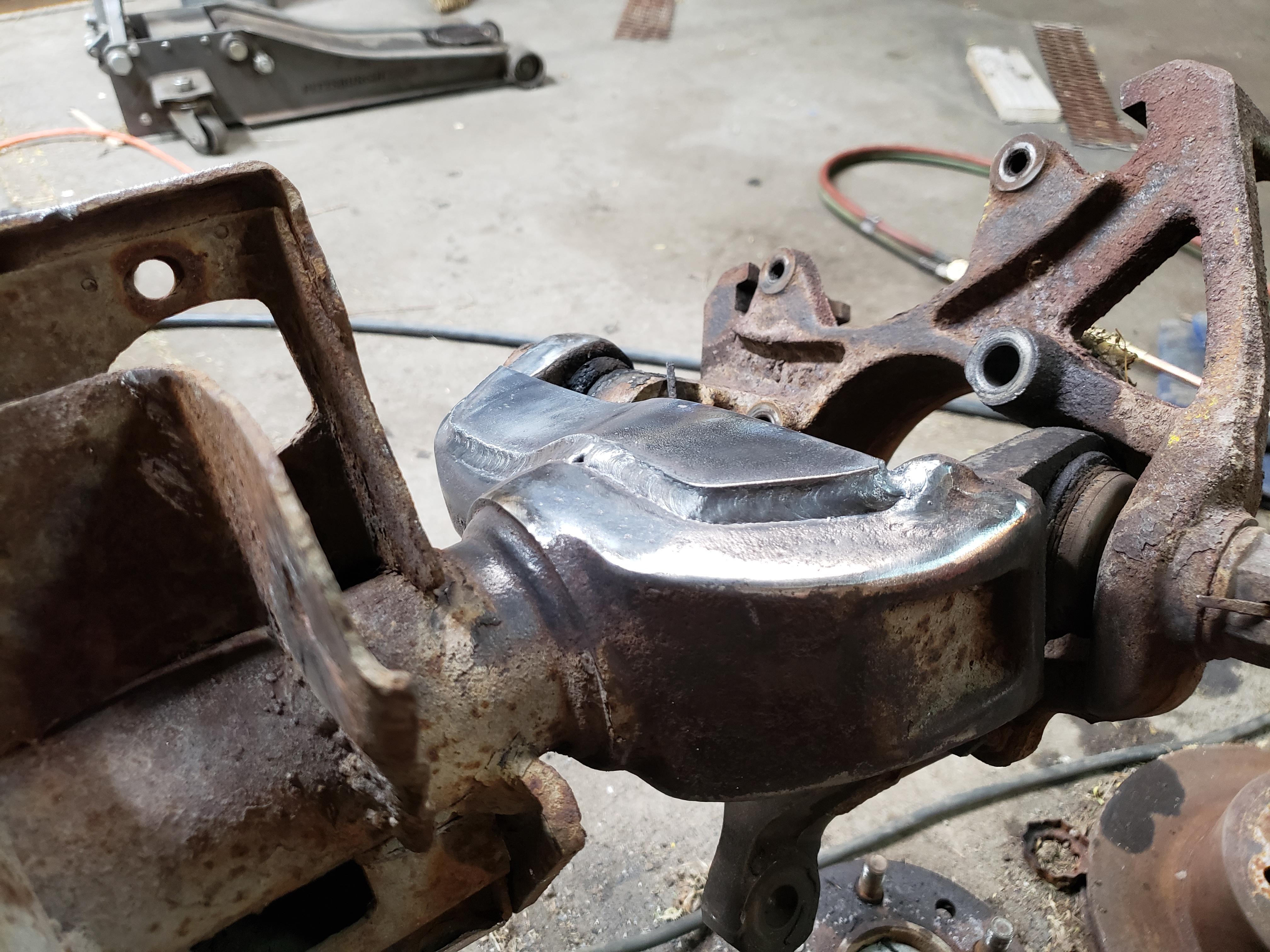

C gussets! One thing I’ve though about with the axle out... but will probably wait until it’s under the Jeep... reason being is I will change the ball joints at that time (after all has cooled) and it’s easier when the axle is being held to the Jeep instead of breaker bars trying to keep it from moving on jack stands
That’s a different front end ya?
What’s the swap for?
Get rid of the CAD axle and get slightly lower gears.
Yes will wait to do balljoints ounce back in. Thinking about hacking the passenger side upper bracket off to truss it. Maybe just leave it off or build a bracket on the truss
I'll probably put this under the jeep as just a houseing then do balljoints and rob knuckles and brakes off the other axle when it comes out.

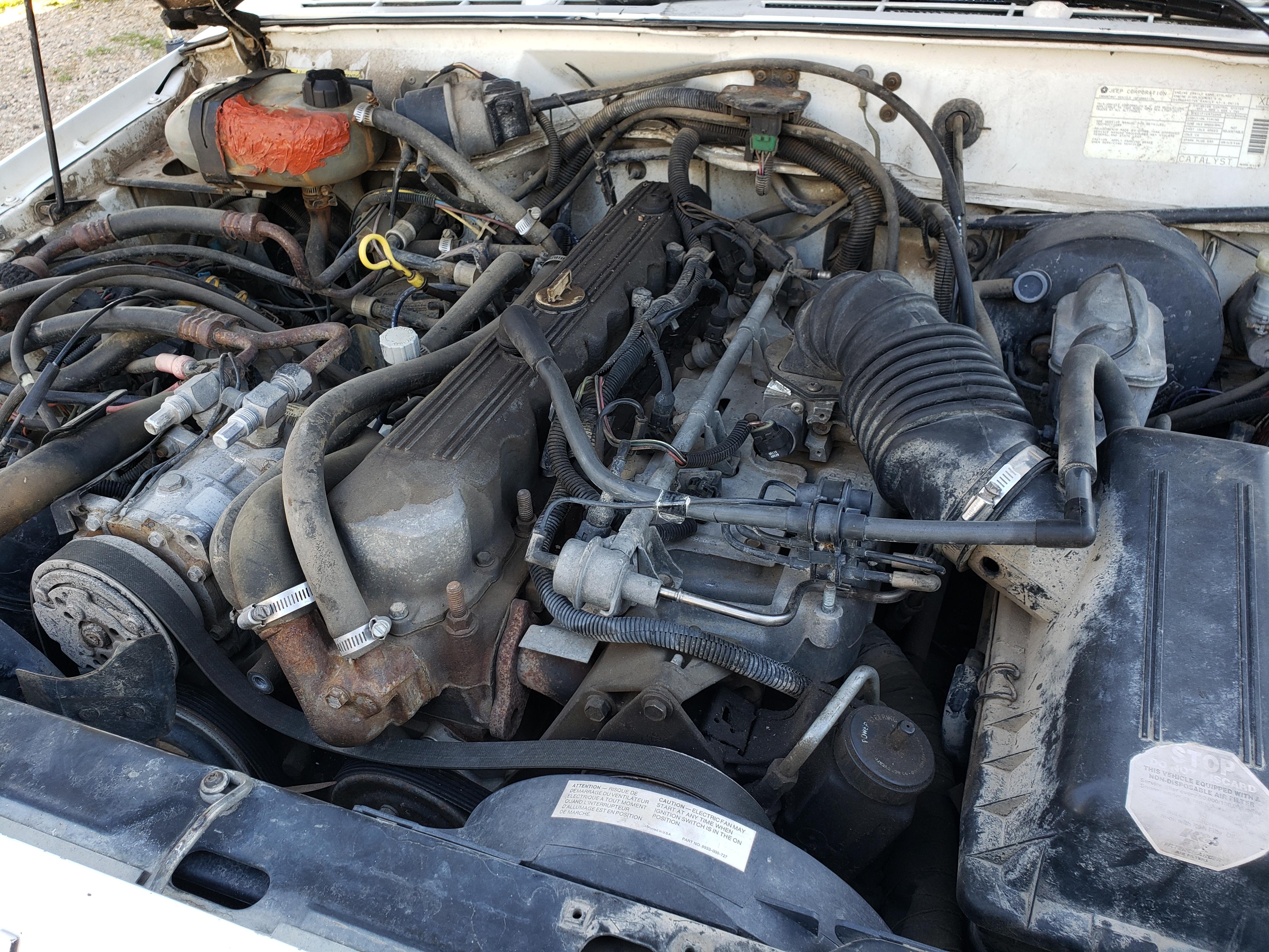

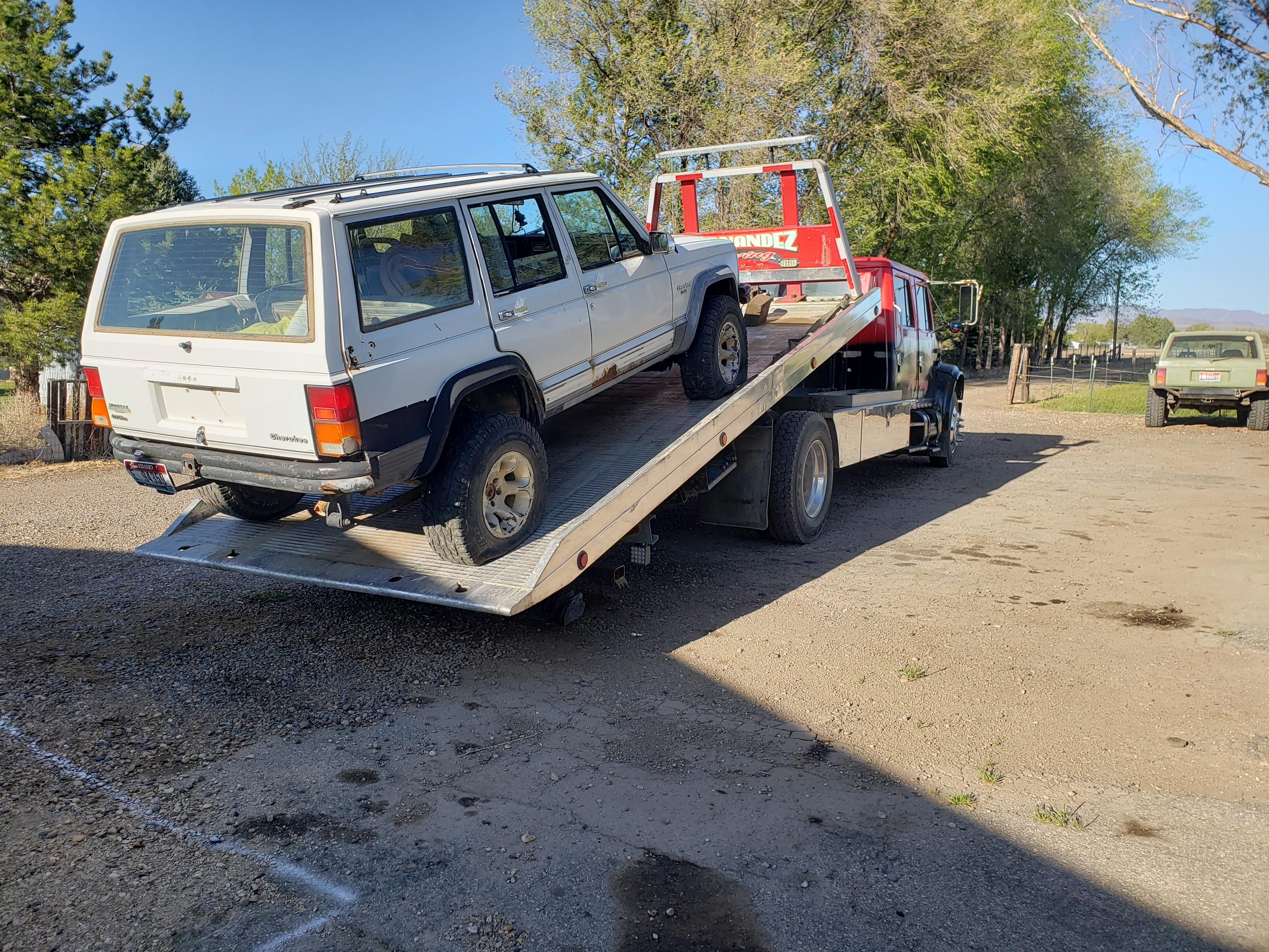

Got it for transmission and steering column. Might be few other good parts on it to.
Whoa shackle bolted to a shackle does have some lift coils in the front.
It will be fun.
I've never had high beams cause my switch is out on mine and column moves when you steer.
My 4th gears gone synchros are junk. Hoping this ones a good tranny.
A white 5 speed. Even better.
That poor thing has had a rough life.
